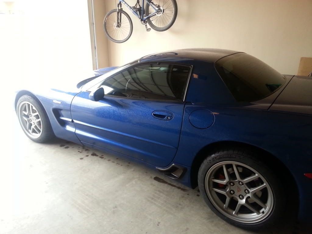

I was looking for tires in stock sizes and there are not alot of options but I see that pilot sport ps2's are available in the right size tho not cheap
I was wondering if anyone has them and are they worth the price?
