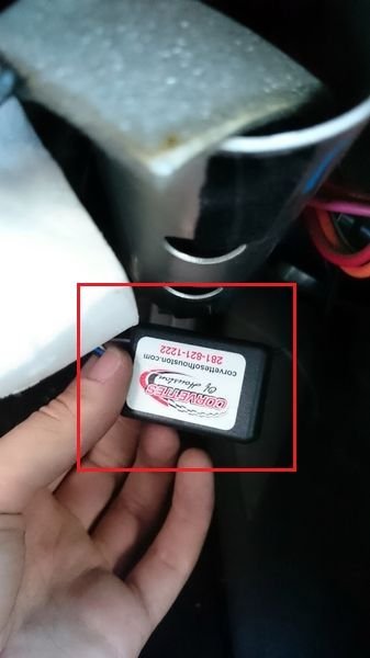

Today i replaced my hazard switch with a new one, and during process i've noticed some things i could not identify. So i need some help, any suggestions are welcome. Here is some pictures:
1. Under the steering column

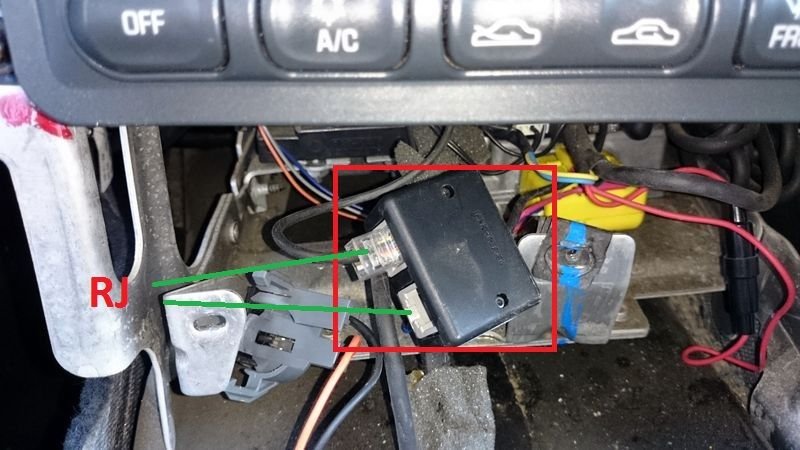

2. In the center console under the climate control.

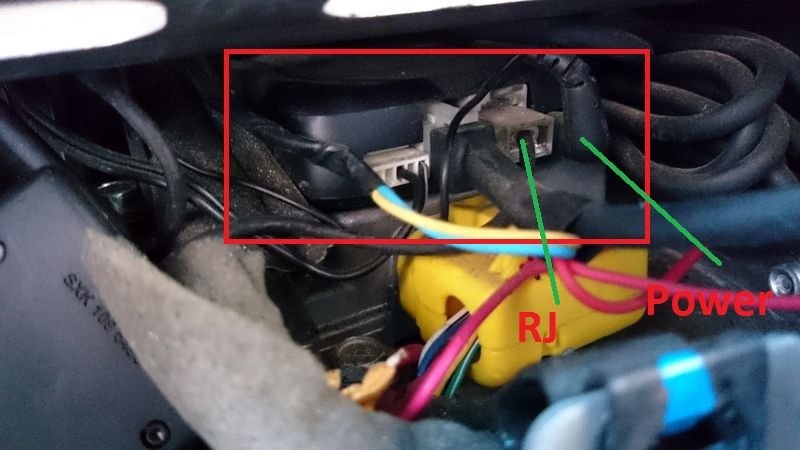

3. Behind the 2 and connected to it

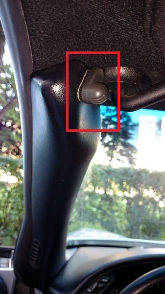

4.
2+3+4 looks like custom bluetooth adapter installed by previous owner. Is it?

#1 Column Lock Bypass.....a must need for ALL C5 Corvettes.
#4 Looks like a bluetooth mic, so I'd imagine it was part of an audio install, and #2 and #3 are leftover from it or part of it.
