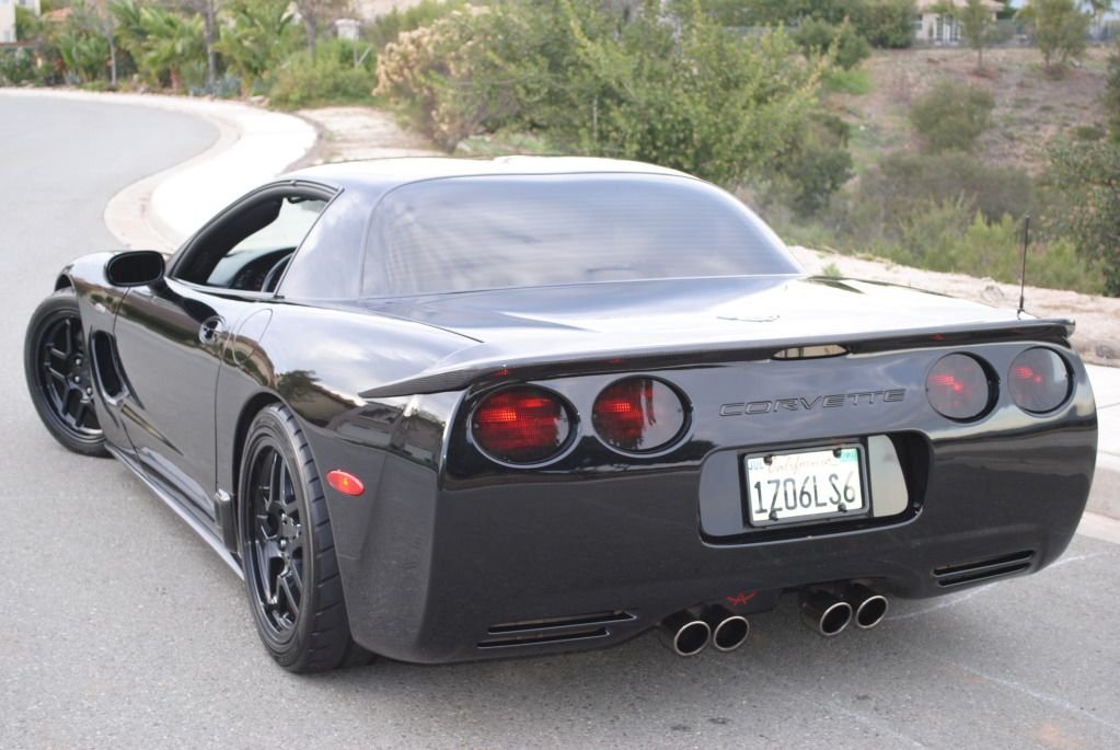

I only used tape. We put three layers of tape on the car then got the spoiler centered and applied pressure for a while (10+ min). She's not coming off. Would recommend 2, maybe 3 people. One spotter and two to install. I did not use any tape on the sides.
Attachment 48371086
Thanks, yours looks great...did you by chance stick down the "fins" on the side that run along the fenders?
You car looks awesome man.

Thanks.
We didn't use any tape on the side fins. I think most people do though. I don't feel it's necessary.
