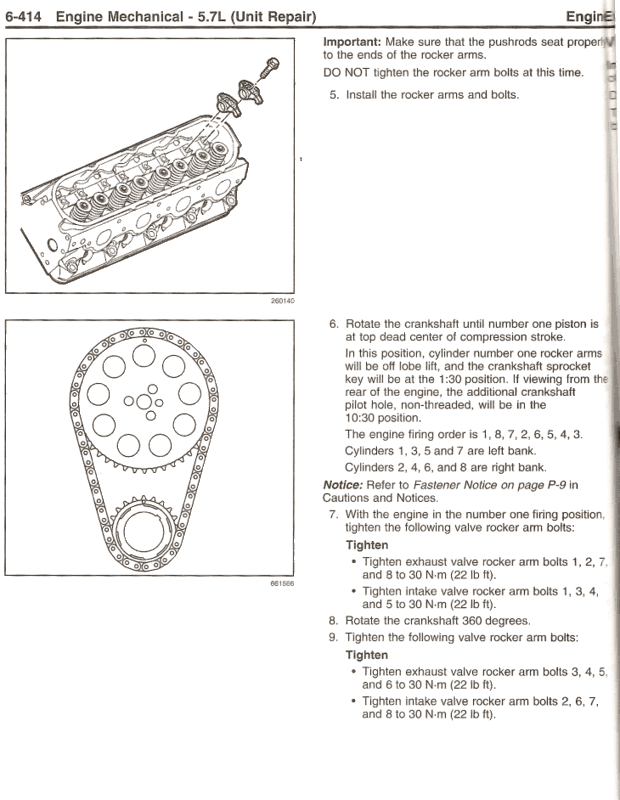

There is no adjustment. The rockers torque down when on the base circle of the cam. This is detailed in the service manual and it needs to be followed.

If your mechanic didn't follow the proper procedure he could have torqued the rockers when they were not on the base circle of the cam. That could make for more noise. Just changing the springs shouldn't change the sound. Print out the page I posted and go see him and see what he has to say.

Also the rockers do not need to be on base circle to be properly torqued. If they are not on base circle when torquing then there is the possibility of the tech/mech messing it up if they are not aware of what to do/look for. When torquing the rockers when they are on base circle there is zero chance of messing it up even if the tech/mech was not paying attention. Service manual calls for them to be on base circle so there is no possibility of torquing them down incorrectly.
Thanks for the info. The engine runs just fine but does have more noise. I'm pretty sure the mechanic followed the service manual instructions - he mentioned how he had to bring the crank to certain specific positions. If the rockers are not torqued to 22 pounds - say to 30 pounds - what happens? Bad things, no doubt!
