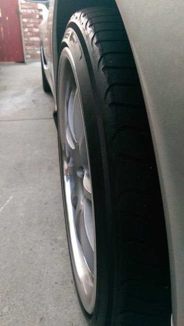

Right you are, so here are some photos I've taken. It'd be very helpful if you could possibly confirm my thinking that my wheels are 19x10 and 20x11.
Front at 275/30ZR19. Doesn't seem too bad.
Front again.
Rear at 285/30ZR20. No clue why the previous owner chose this size, but I don't like this stretch.
Rear.
Also as mentioned before, all tires are Pilot Sport 1.

Given the stretch, I'd say that you are not far off with your size guesses. I believe my wheels displayed their sizes on the inside of the hubs (offsets were stamped back there for sure), so you can check to verify, but regardless, a 275/30-19 fits your fronts well and you can definitely accommodate another 20mm on your rears without any problems whatsoever, so my tire recommendation remains the same
