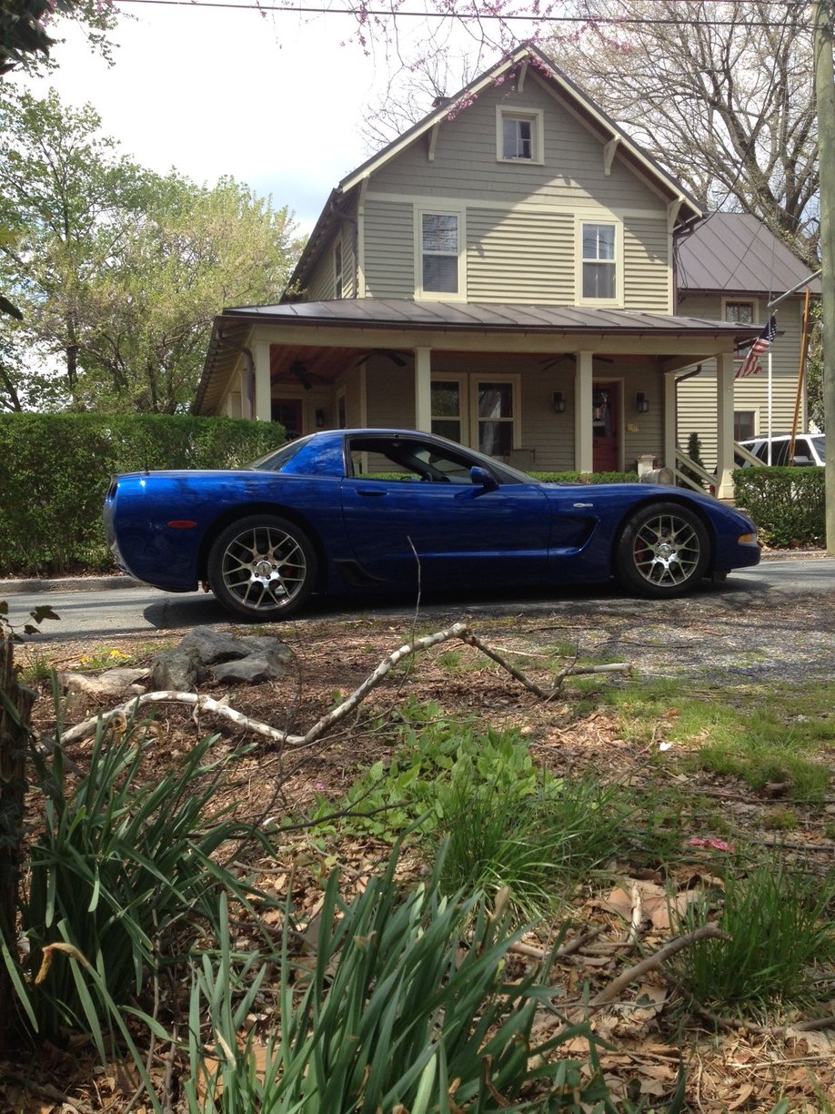

So I bought this Z back in the Spring and it has the Pfadt stage 1 johnny O shocks and sways and I believe it's lowered slightly from stock. It is corner balanced etc... It handles beautifully...but from an appearance standpoint I feel there is too much gap in the wheel wells especially in the rear. I only see 3 threads showing on the stock bolts so I'm assuming if I want to bring it down, I'll need extended bolts. Question is, how low can you go before you are on the stops? I don't want to jack the handling up but I want the "look". I'd hate to have to go to coil overs at this point. Suggestions? Here's how it sits now:

Unfortunately, you can't go too low on these cars without negatively affecting handling and making it very troublesome on public roads with driveways and speedbumps.
Back in the C5 era, having that little fender gap EURO look was not a priority.
The corvette engineers did a great job with handling (san the 01-03 shocks), but didn't provide the proper look.
I just don't think you are going to get the look you want without affecting public road streetability and handling. You lower too much on these cars and you negatively affect the geometry too much.
For a C5, you have a pretty good look there compared to stock already.

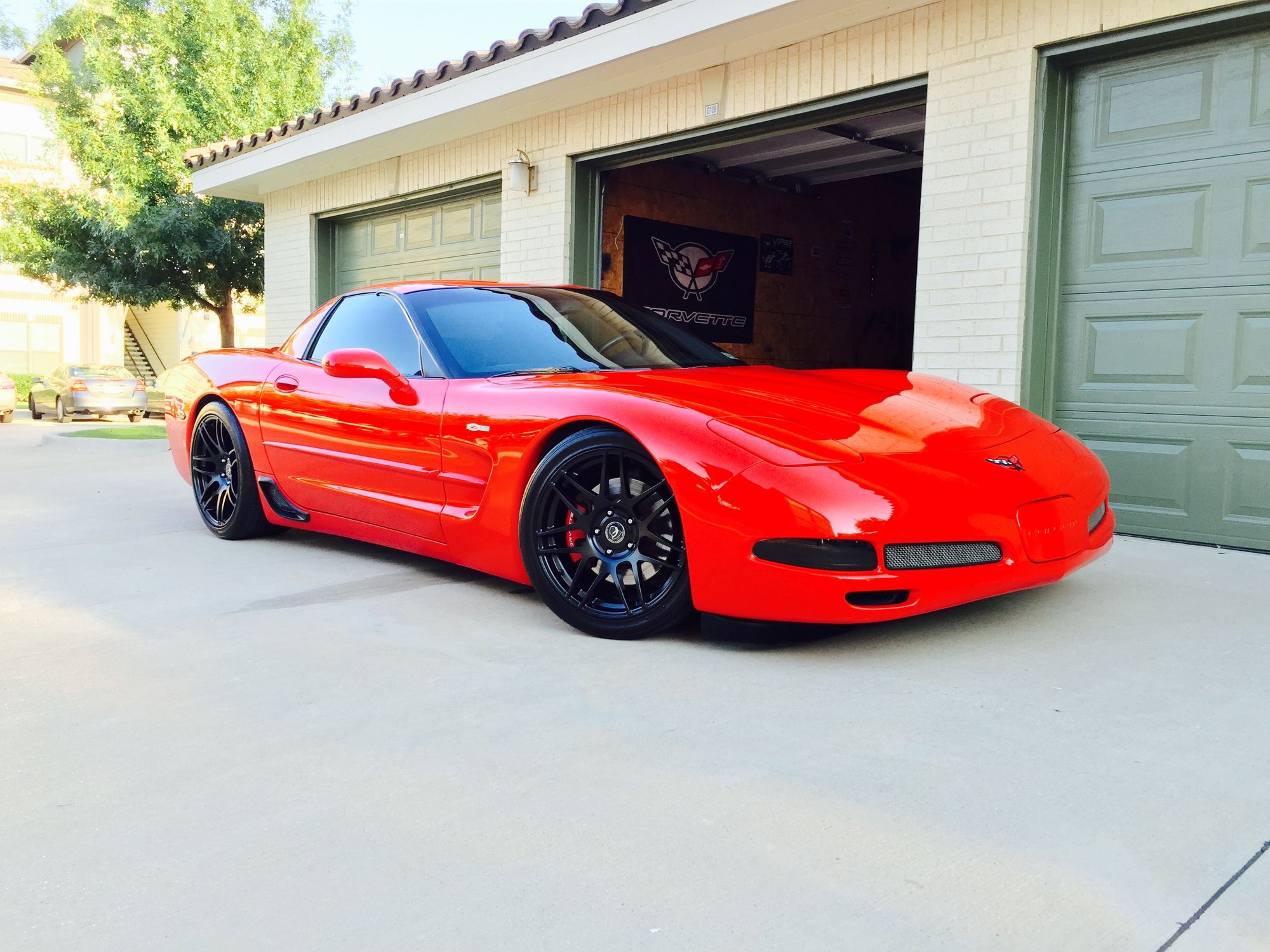

Im lowered on Zip bolts but also have Bilstein shocks, rides a littler stiffer but not bad.

I went with pfadt feather coil overs instead of bolts so I keep an aggressive stance and maintain a great smooth ride. Love the style of the house.

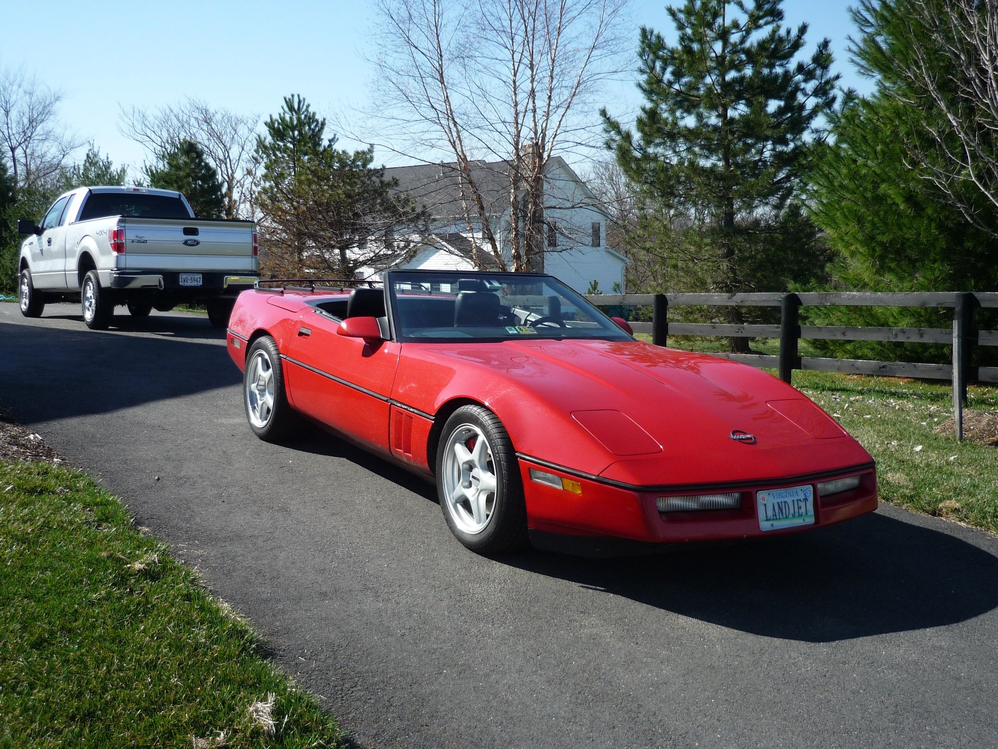

zdeckich and old C5, that is the stance I'm looking for. I don't want to jack up the suspension geometry. It handles incredibly and the PO set it up for high speed HPDEs and said that there needed to be some rake. So I'm torn. My old C4 was dropped and I loved the look:

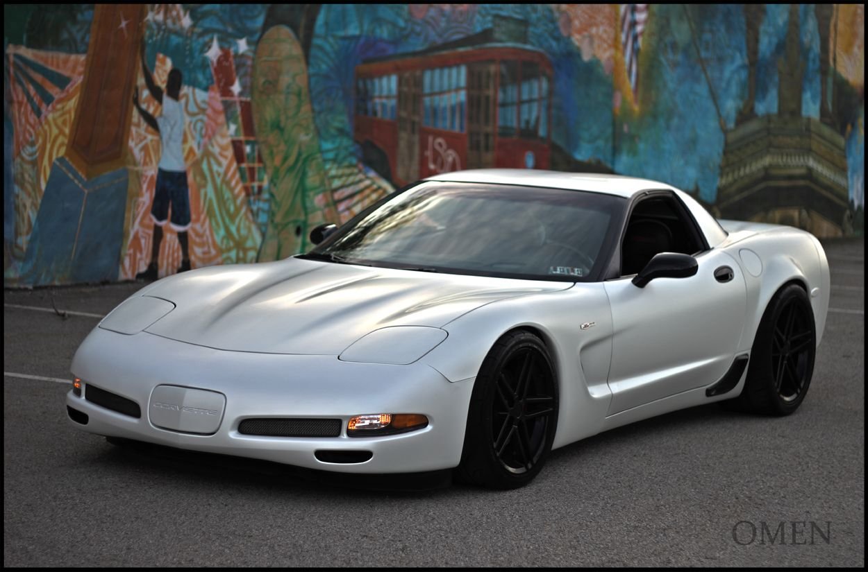

I was at the ride height below on stock equipment. I actually removed the front adjusters entirely so the spring sat directly on the lower arm. After 1.5 yrs, and removing the entire suspension to coilovers, there was no negative impact from the adjusters removed.
I will say, that from stock, I did see a drop in capability at the limit, though it wasn't as significant as made out to be. In the end, people talk about race standards, when we are discussing a street car. I still outhandled or stayed with anything I cruised with on saturdays. Yes it was a reduction, yes going to Pfadt Featherlights was a great improvement, but would I change reducing the ride height on a street car if it cost me .1g or 3 seconds at the track...nope. How much do you track it versus how much do you look at it and admire it. For me...stance is everything...
