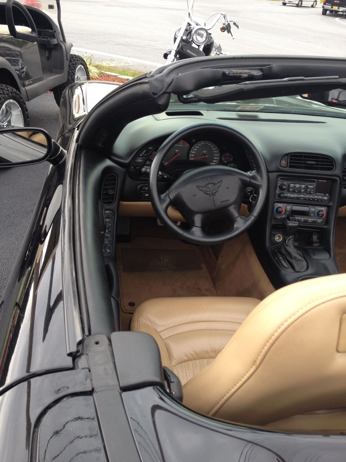

A couple of pictures of the 99:
Picture of the 01:

If it were me, I would go with the '01 - I like the color better, it has a bunch of upgrades to the platform compared to the '99, you can get replacement parts/repairs to certain parts (EBCM in particular) and for what it is worth the HP is a bit more (5 additional ponies).
Is the price on the '01 definitely firm or is there room for negotiation there too?

In my opinion the 01 would be my choice, It will have the upgrades and you can still get parts, The 99 parts are getting hard to find like EBCM and it is not repairable like the 01 is.
Black looks great when clean, But it is a pain to keep spotless, The Pewter is a classy color and very easy to keep looking, I have a pewter and love it. Also seeing you are looking at automatics, Check the RPO codes in the glove box and look for a Z51 code, That will give you the better suspension and better rear end gears, The automatic with the standard 2.73 gears are some thing else. lol

99 looks clean, aftermarket exhaust, c6 wheels, painted calipers, but the 01 platform is upgraded and just because of that I would choose it over the black one. Pewter is nice as well. Check the reverse lights, make sure they come on, the selector switch at the tranny could be bad.
