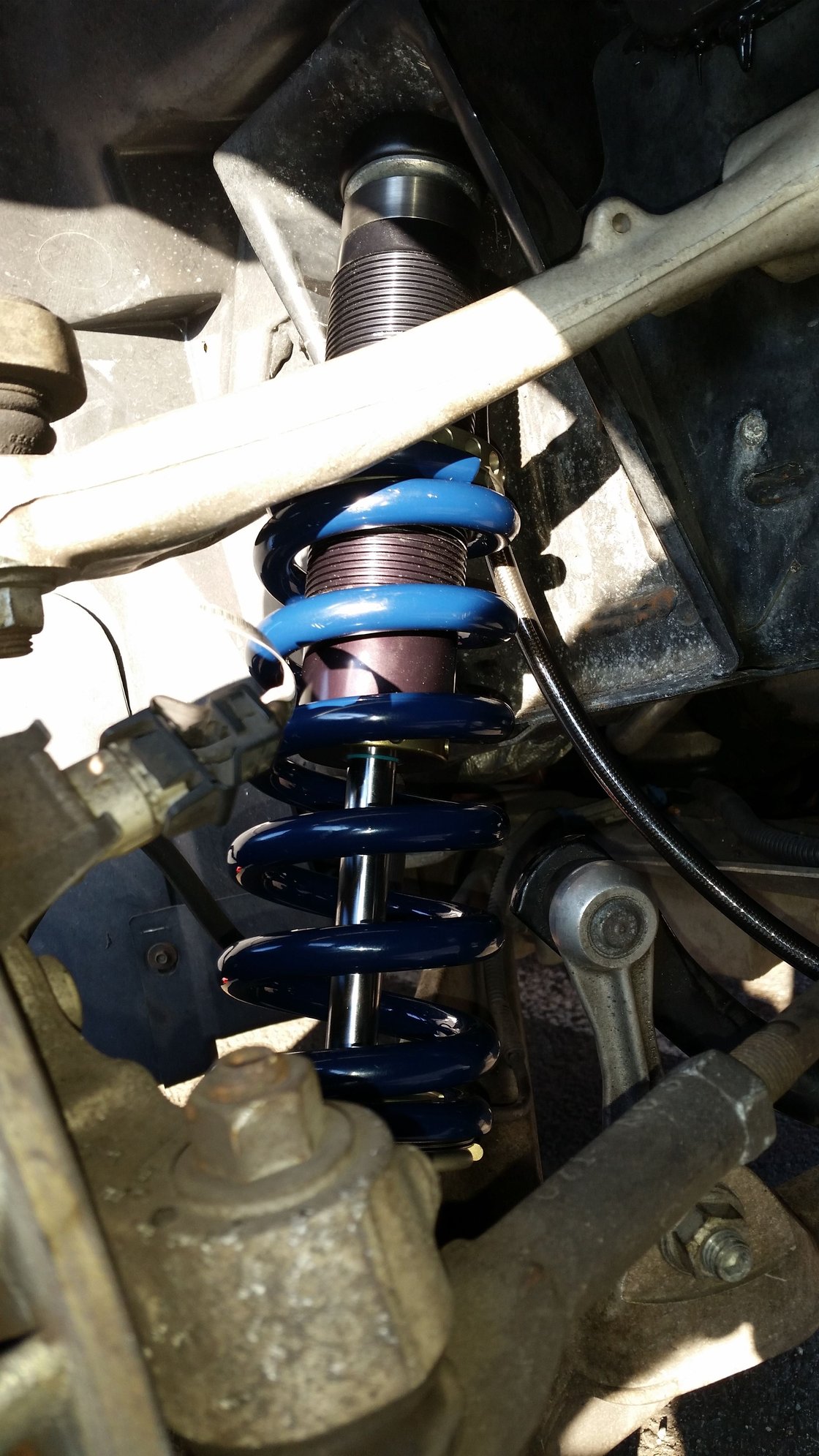

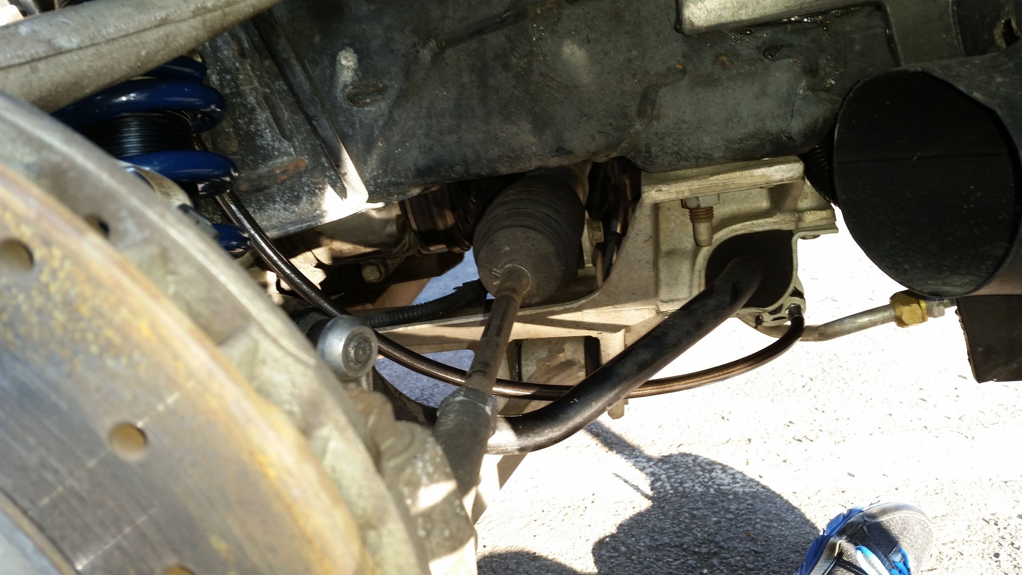

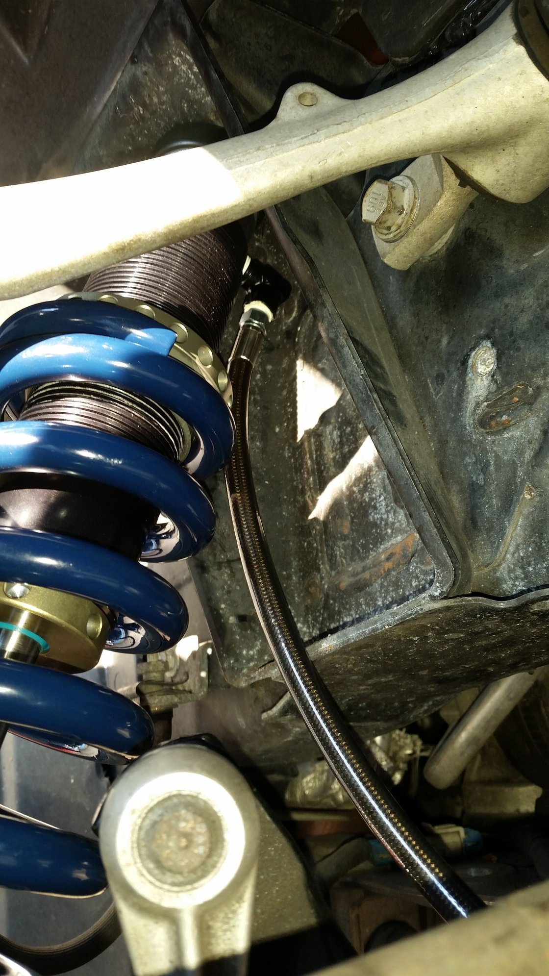

So I ended up not having the tools needed to cut the spring and had to go with the method of unbolting the lower control arm. Got it done though and I could not be happier! These shocks are incredible. The range they cover from streetable comfort to hard cornering grip is beyond what I expected.
For the benefit of others searching for help on this in the future....
keywords: penske coilover reservoir install how to
There are a bunch of ways you can do this but I had 90deg fittings out of the body pointing down and straight fittings into the reservoir. I opted for mounting them low behind the radiator. I don't recommend using zip ties for the long term though. It is tight on space with the coils so I removed the tie rod to make life easy.
I was in a rush and didn't snap pics of the rear but its very easy to mount them to the lower control arm. I'm glad I didn't have to cut the chassis at all but I will probably install the Penske Rezi brackets in the rear. There is a great spot to bolt them to but I'll have to switch the rear reservoir fitting to a 90deg. I also removed the tie rod and upper control arm bolts to easily install the shocks in the rear.
