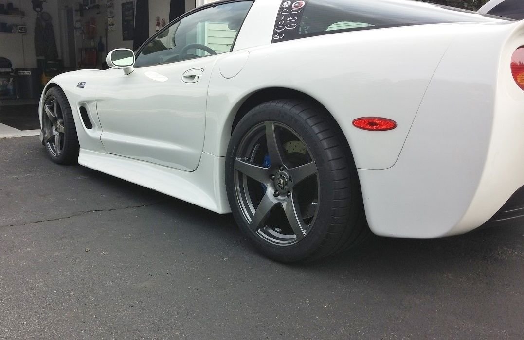

I've gathered I'm pretty much limited to Forgestar or Cray. Forgestar offers the concave I want available for the vehicle and no I can't justify spending $5k on a vehicle I paid $15k otd.
Now it's really a discussion on what sizes I can fit up front and if anyone has 19/19 they enjoy as CF10s are roughly 22lbs vs the 21lbs and 18x11 F14 is. So once again I ask will an 18x11 et 55 fit up front on a 275 or 285 tire? Does anyone know if the 18x11 or 18x10 has the same "face" (amount of concavity) ? I am really only looking for wide rims because they offer concavity.
Also if anyone cares to add knowledge. I have a feeling with wider front tires and wheels my rockers and doors will be more subject to my wheels throwing rock chips to them - am I right in thinking this? Secondly I hate the look of front "mud flaps" (forget what they're called) I have seen the C6 looking rear fender guards (mud flaps) that look amazing - mainly saw these in the widebody fender thread. I'm not sure if they're different than ones I've seen sold by RPI but they certainly look cleaner. So I like them in the rear but am curious of protection of the front. I was considering after winter to get the chips in the front touched up and then using expel to protect the other bits.
Any thoughts?
Edit: Yes I am looking to do a square wheel and tire set up - let the discussion on nannies begin. It seems some have issues while others do not
People run OEM C5Z 18x10.5 +54mm rear wheels on the front occasionally, so, yes, the 18x11s will "fit". However, they will poke the tires out past the fender a bit.
If both wheels have the same amount of offset, then the wider wheel should have more concavity.

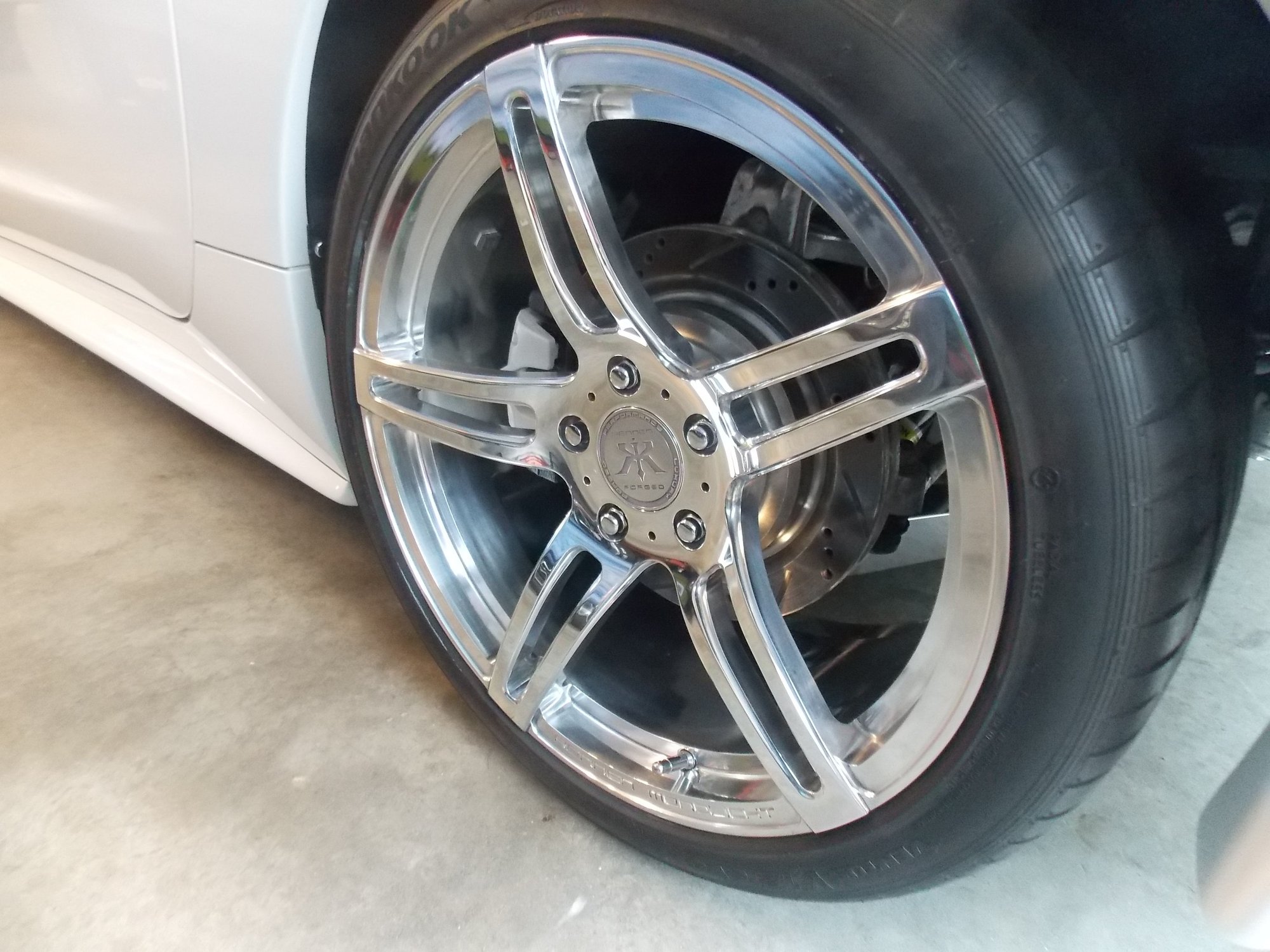

Check out Rennen Concave MS5 mono block.

I have the Rennen M5S Polished Monolight Concave Wheels 18x9 Front and 19x11 Rear

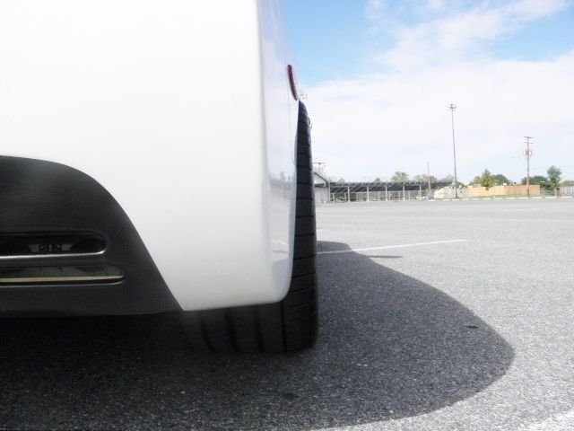

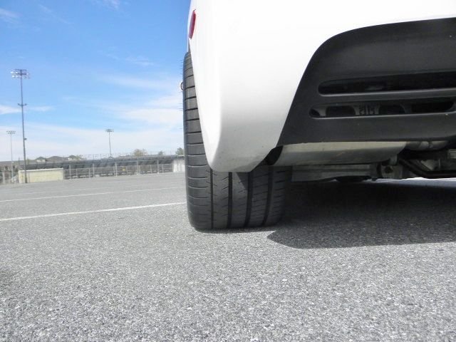

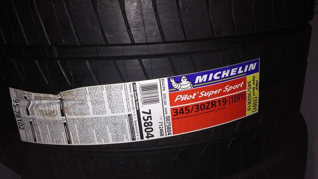

I had run a 285 up front and 345 rears with HRE 540 a while back. The fronts were just a bit too wide. My last 2 sets of wheels including my current CF5 setup are 275/35/18. With a 44mm offset up front and 345/30/ 19 with a 43mm offset rears wrapped with Michelins PSS. I have tubbed rear to fit these in the rear.
