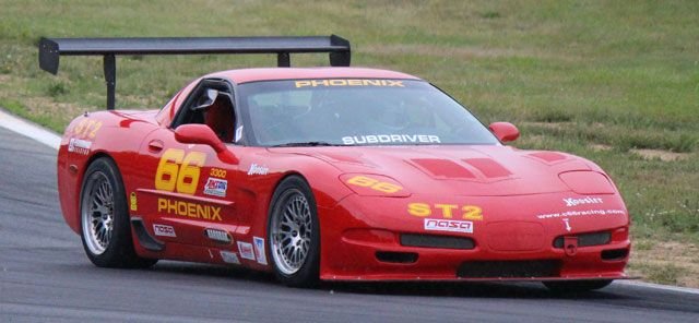

A little late, but been browsing the forum for wider fendors and tripped on this relatively recent thread.
I switched from SCCA T2 to NASA ST2 in 2014 and did a Black Dog facia and splitter and Kognition rear wing.
My mods are listed here:
http://www.c66racing.com/NASAST2Vette.htm
