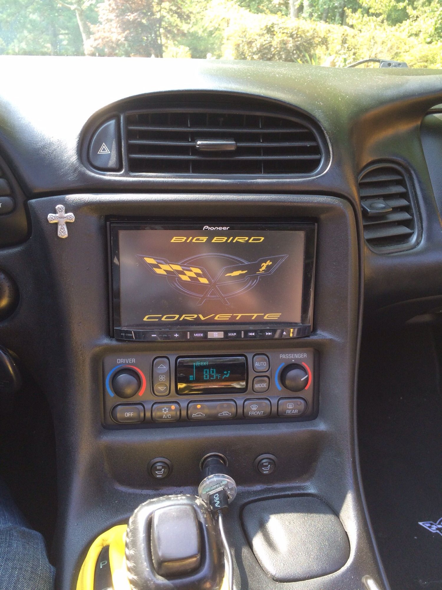

I changed mine out in a day,I used the ROEM VET1 and did the bezel mod using ABS cement, it worked better than epoxy. Pioneer Avic- z150 all the bells Bluetooth, sat, HD radio, nav, rear view camera, iPhone app.
I have switched out the cigarette lighter plug for a duel USB PORT.

I like what you did with the seat heater buttons and power outlet. I'm going to be changing my center console and I'm debating how I want it to look when I'm done. That's a good look I'll have in my mind when designing mine.

hey.... I never knew they offered seat heaters in c5s .... Did you add that yourself?

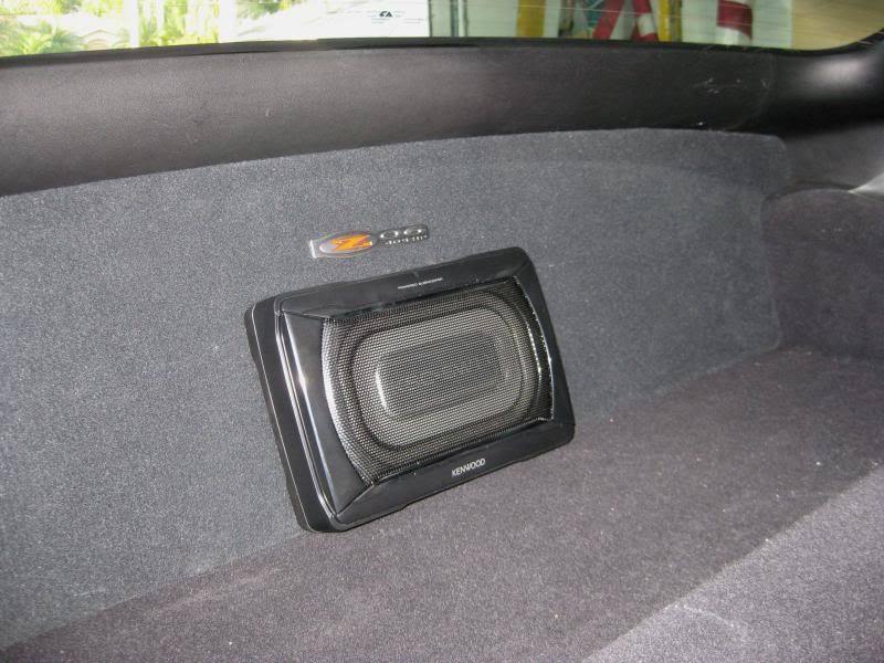

Why use any of the old system. If you think because it's Bose it has to be good, your wrong. Trash it all. Single din or double, run new speaker wire. Buy some good speakers. I ran the blue wire back to a really small powered sub and it all sounds great.

This little powered sub really kicks ***. Best money I have spent on my car.

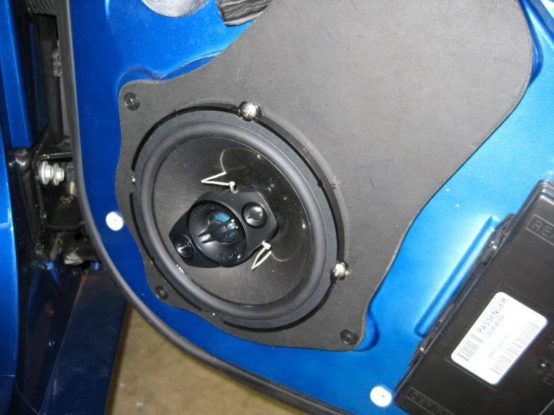

Dennis is definitely good people. I bought a JL audio 10in sub in his custom box for the spare tire well. Fits great and paired with a cheap 400watt amp, it sounds awesome. In a vert ta boot........
