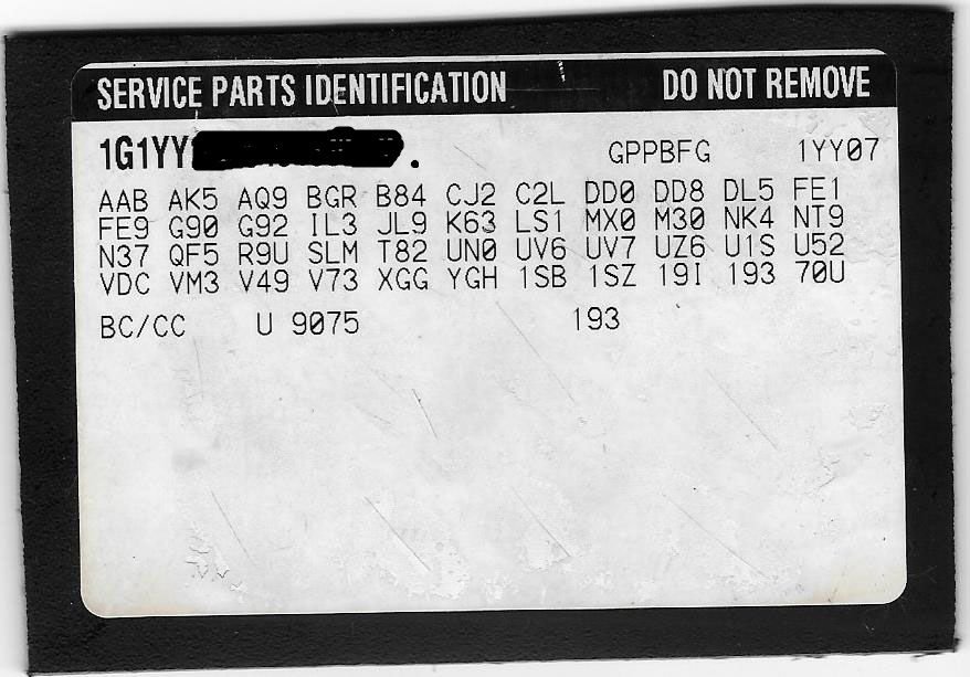

As far as I know OEM Code 70 has been the only code for every year Torch Red was used. But on the RPO Label it's listed as :
70U BC/CC ( Base Coat/ Clear Coat ) U9075
"GM code WA9075 - red
This red automotive paint color is most commonly known as Torch Red. The color formulation has been used between 1990 and 2015, primarily by GM. Variations of the exterior paint code WA9075, which may appear on body data tags include: 9075, U9075, and L9075 (the prefix U for upper body, or L for lower body)."
I looked and have not found any indication that there are 2 shades of the same color.
Here is my RPO Label off of my Torch Red 04 so you can see what to look for on yours !

And just to reinforce SG LOU's RPO label, here is mine from my 2003 Torch Red Coupe.
Same 70U BC/CC U9075 designation.
