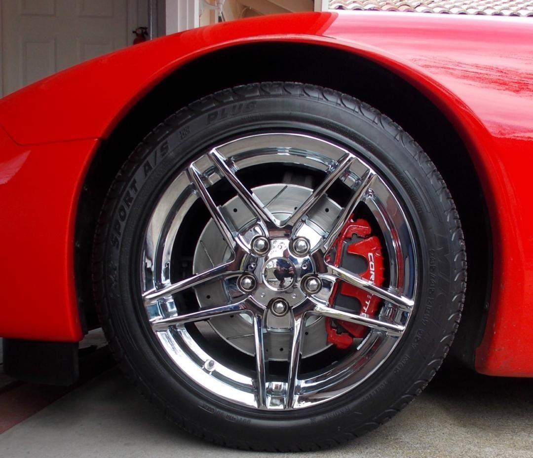

Two years ago I painted the calipers and installed drilled slotted rotors on my 2004 coupe. I got a set of 4 rotors from Brake Performance (there in S. Calif.) that are black zinc coated. The rotors were $268 for the set of 4. This was, by far, the best deal I found of all the places I checked on the internet. The rotors are of excellent quality and will not rust. Installing the rotors really is easy. Some of the calipers bolts can be tough to break free. For those, I took the jack handle off my jack and slipped it over the ratchet handle to increase leverage. A short piece of pipe can also be used. This makes breaking free even the toughest caliper bolts easy. Don't be afraid to do this job yourself.
