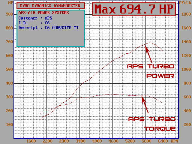

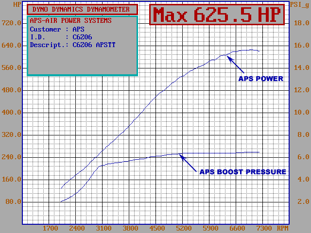

I wanna buy one of these but after buy, i will mod aps twin turbo kit.Here is the values after aps kit.
Z06
Z51
So z51 is sense to buy?

z51 doesn't show the boost it took to make that power, more than likely it is higher than the c6z or has more mods and that's why it made more power... if I was going to boost a c6 I would get an ls3 grand sport, you have the widebody of the c6z but the car costs less
Z06
Z51
Nothing makes sense unless you have more details about this dyno runs...boost level, air fuel ratios. LS7s are not boost friendly whereas LS3 are.
