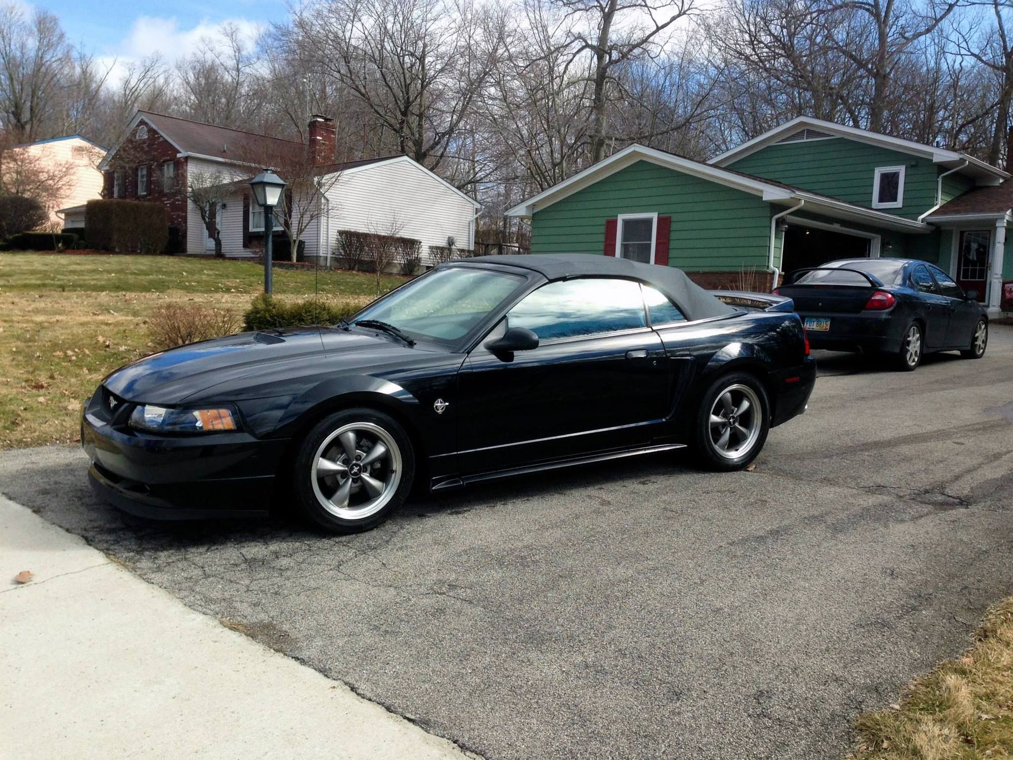

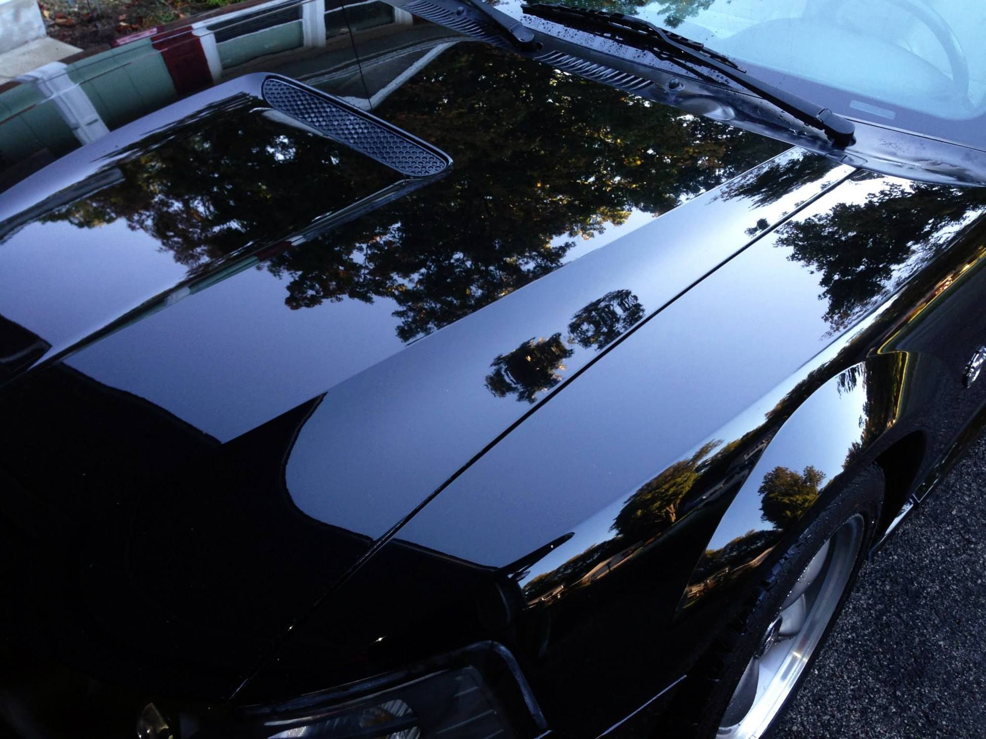

To ***** a little more; some examples from a cheap 99GT I quasi restomodded for my dad.
Paint was BAD. Lots of stains, imbedded grit, scratches/swirls
Wet sanding with 1200/mild detergent as a lubricant
After the XP 2 step, and a shot of Blackfire sealant as my 'test spot'
Then began the process of hating life...you will put in some serious time doing this. It can take anywhere between 6-20hrs just buffing a car to really a fill correction based on size/damage and do it properly. More if you like to wetsand.
I'm leaving out a ton of results pics as I'm trying not to steal too much away from here, but yeah... it's worth the effort.
New top, interior, suspension, refurb the bay/underside, blah blah...but the paint; yeah swirl free and deep enough to get lost. near 160k paint.
