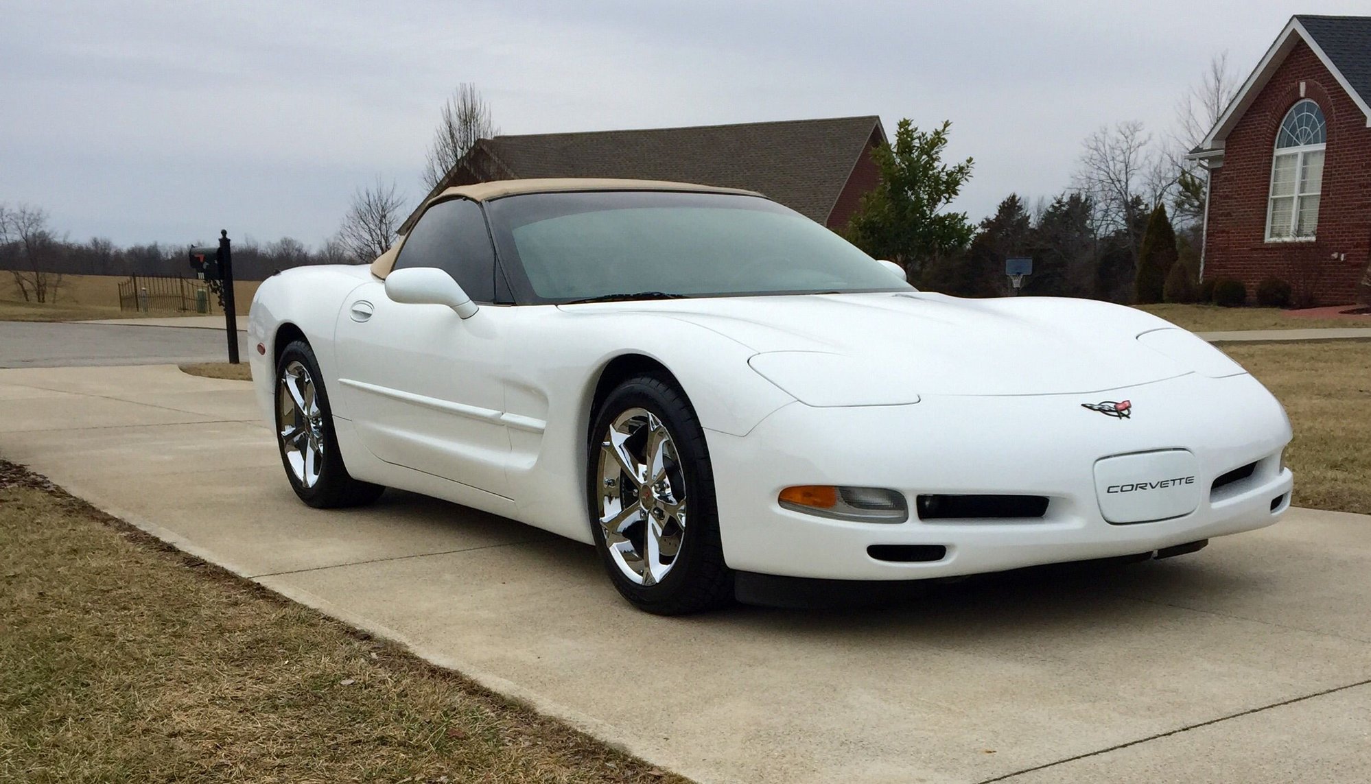

Lowered our vert yesterday. Took the back down 6 threads and the front down 5 full turns. Thoughts?

Looks great now don't forget to have your frontend alignment done or your tires will be ruined in a short time.

Looks good to me. Doesn't look low enough to cause many issues.
It does look like the rear is a little lower than the front? Could just be the camera angle. I think in general people usually lower the front just a tad lower than the rear.

Not low enough

Looks good to me. I like the lowered look and am considering having hat done to mine. Only thing is I would be worried about scratching or scraping it all the time

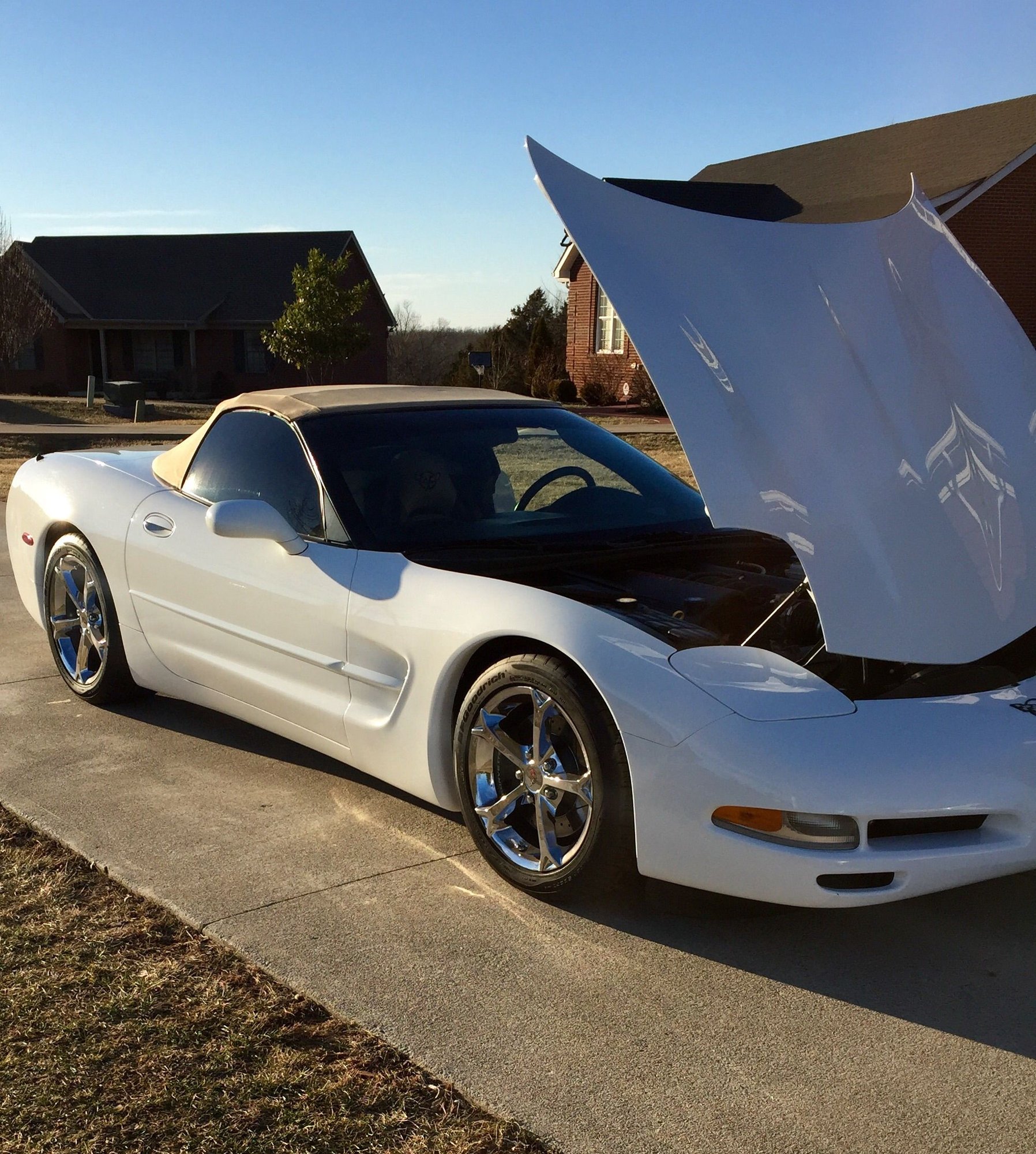

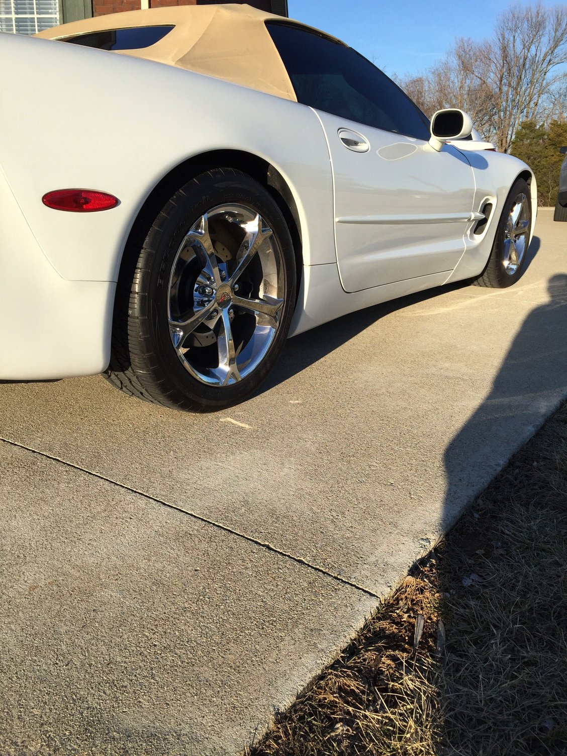

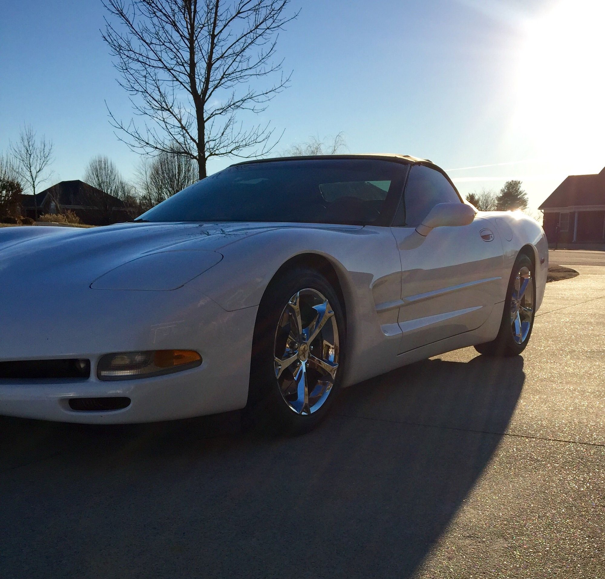

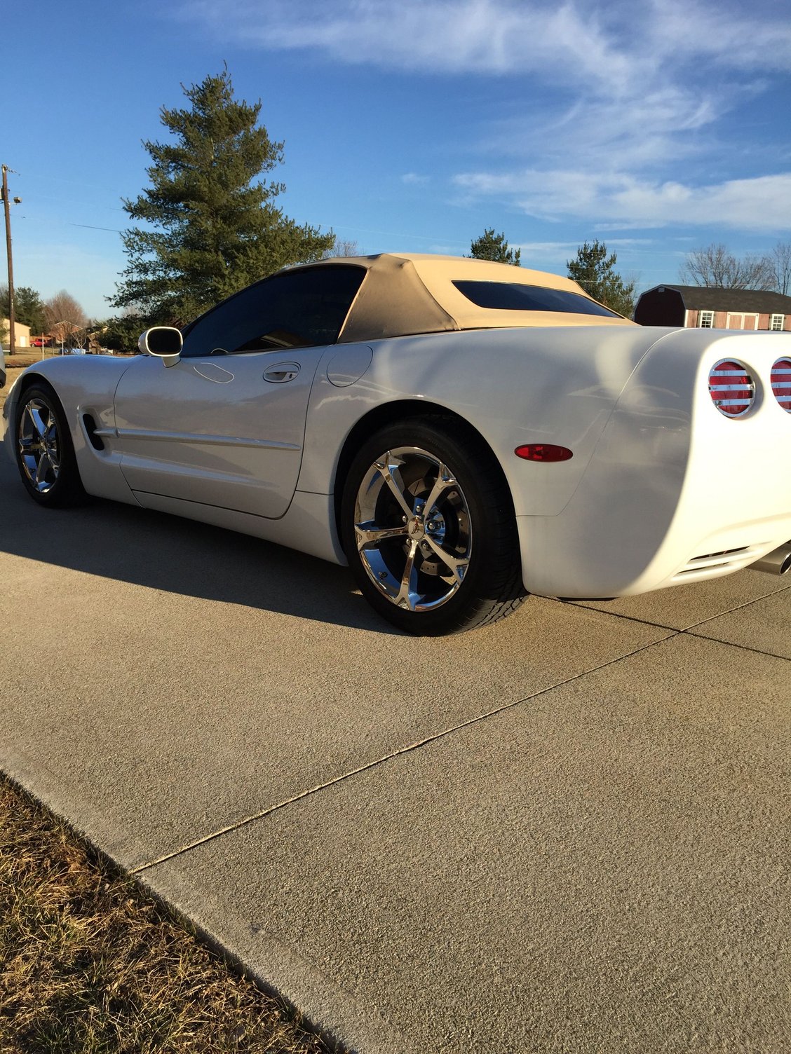

Here is a few more views. I think the rear is slightly higher but will get a couple of side pics to verify.
I wondered if it was low enough to fix the stance appearance. It certainly couldn't be any higher. The front bolts stopped turning right at 6 full turns so I backed off one. I didn't want it all the way down but it doesn't look as low as others who used the stock bolts.

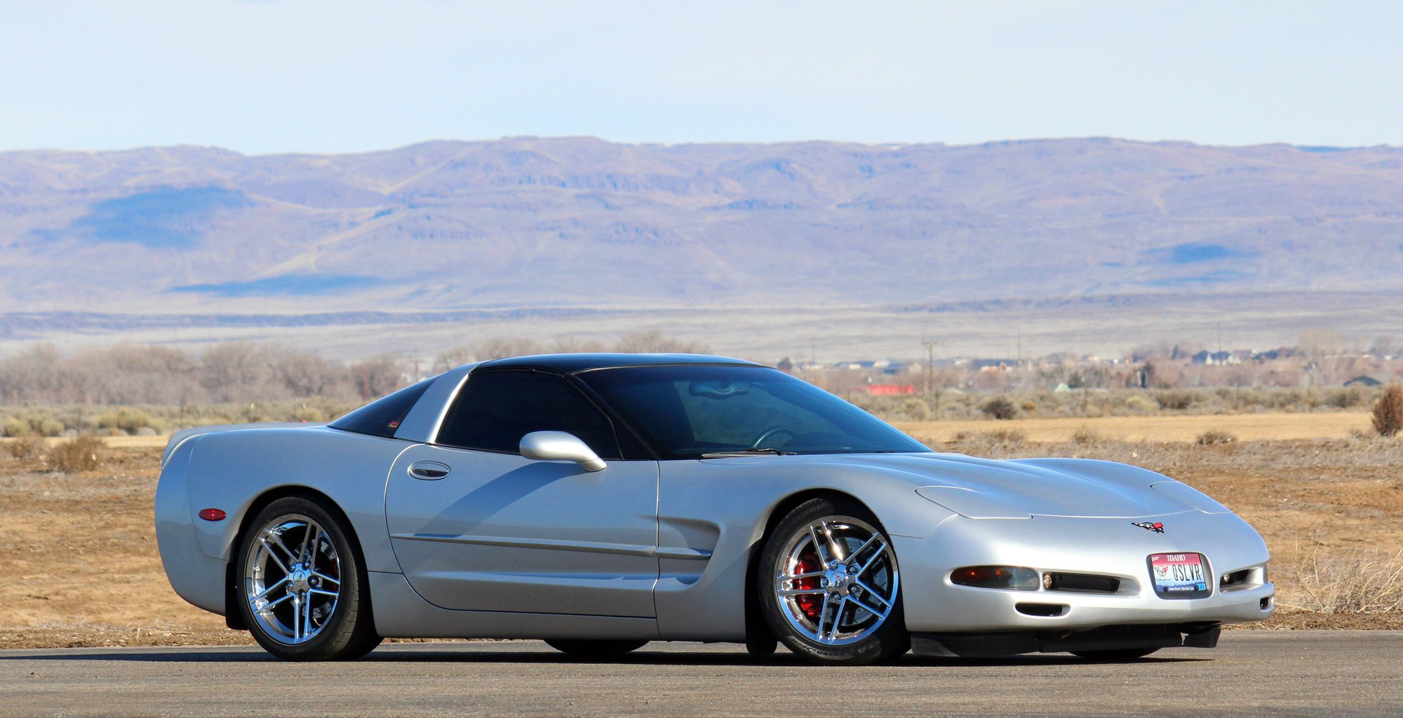

Before:
After:
Old Feb 8, 2015 | 04:13 PM
Oh 2 Fun's Avatar
Oh 2 Fun
Joined: Oct 2007
Posts: 6,868
Likes: 770
From: Kelso Washington
St. Jude Donor '09, '13, '15
Looks good. I did mine quite a while ago on the stock bolts but didn't take it clear down. Looks way better but the ride got harsher. However, I also added C6 Z06 sway bars at the same time, then had it aligned.
My ride height is about the same as yours. It does scrape a bit more but you learn to compensate for it in ways.
Maybe someday I'll fill the wheel wells with a different wheel/tire combo, but for now, I really like the look better.
