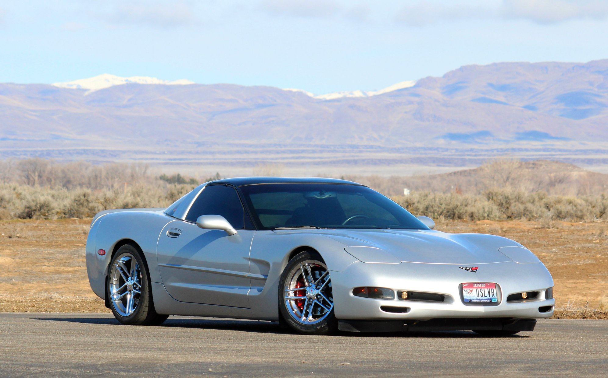

I need info regarding what size 19" tires would fit on C6 chrome wheels? The C6 came with 18/19 and C5 came with 17/18. Can this mod work? I have searched this forum and no luck with info. I'd really appreciate anything you guys can tell me.

simple answer yes. which c6 wheels will depend on if you need a spacer/adapter. you can buy the c6 replica wheels in c5 offsets. there are many threads on this.
here's my personal car with factory c6 z06 wheels on it.

I was considering using the OEM C6 Z06 wheels on my 2000 FRC but that's a little too much tire sticking out past the fender.
