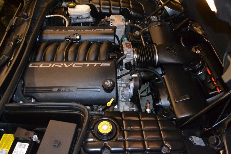

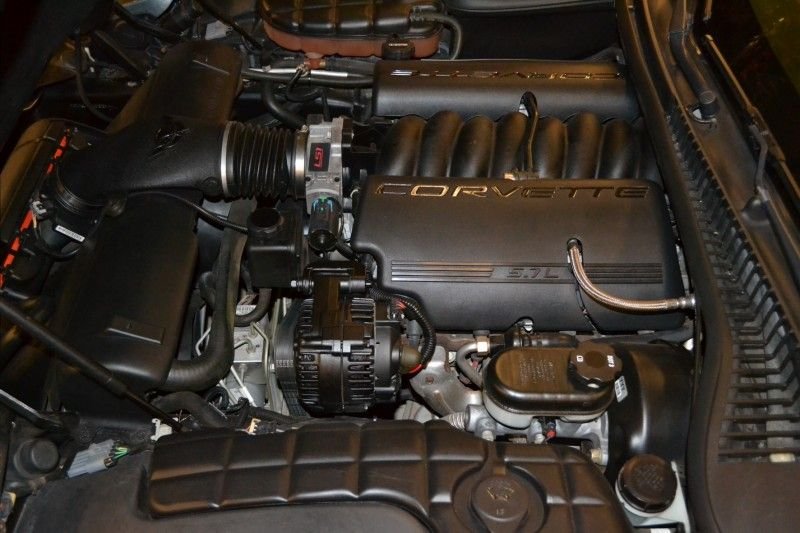

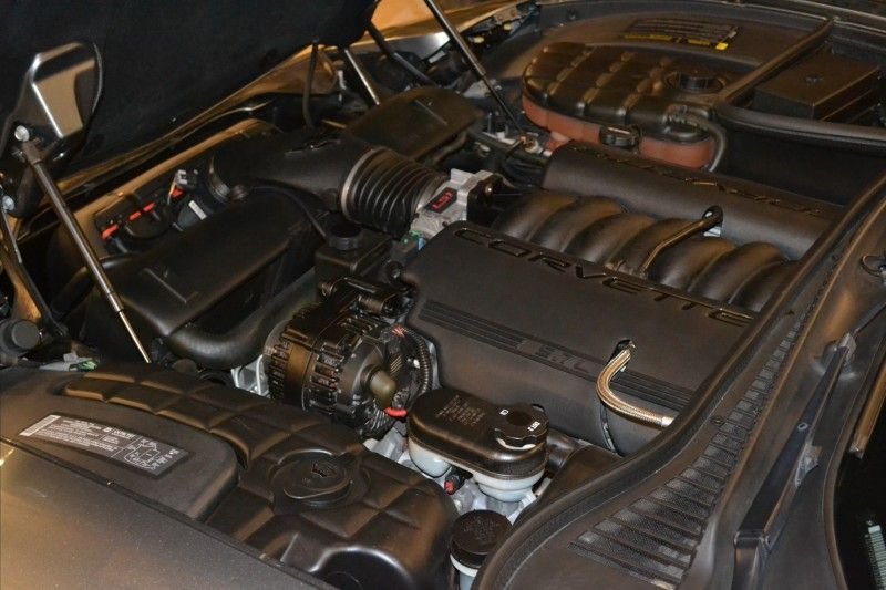

I would use caution just "power washing" under the hood of a C5 at the car wash...just take a look around the forum at "electrical issues" and most of that is probably... without putting water at high pressure on electrical components ON purpose. I'm not saying others have done it without any problems, but I won't do it.

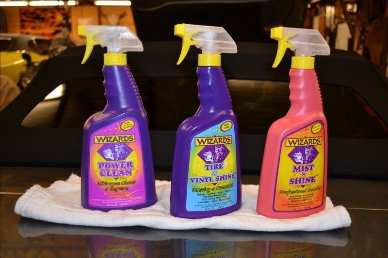

This is what I did to my filthy (previous owner) engine bay. With these products I had great success with minimal effort!
I covered the alternator with a little cling wrap.. took off the fuel rail covers and soaked the engine bay with the Wizards Power Clean... let it set and then just rinsed it off with the garden hose. Then took the leaf blower and dried it off. Follow up with the Wizards Vinyl Shine and had a professional detail looking engine bay...
A picture is worth a thousand words.. and Black is hard to keep clean!

Great info and even get pictures...thanks everyone for the advice. The engine is not too dirty, just has stuff in all the nooks and crannies that I don't like to see.

...now that's clean!!!!!

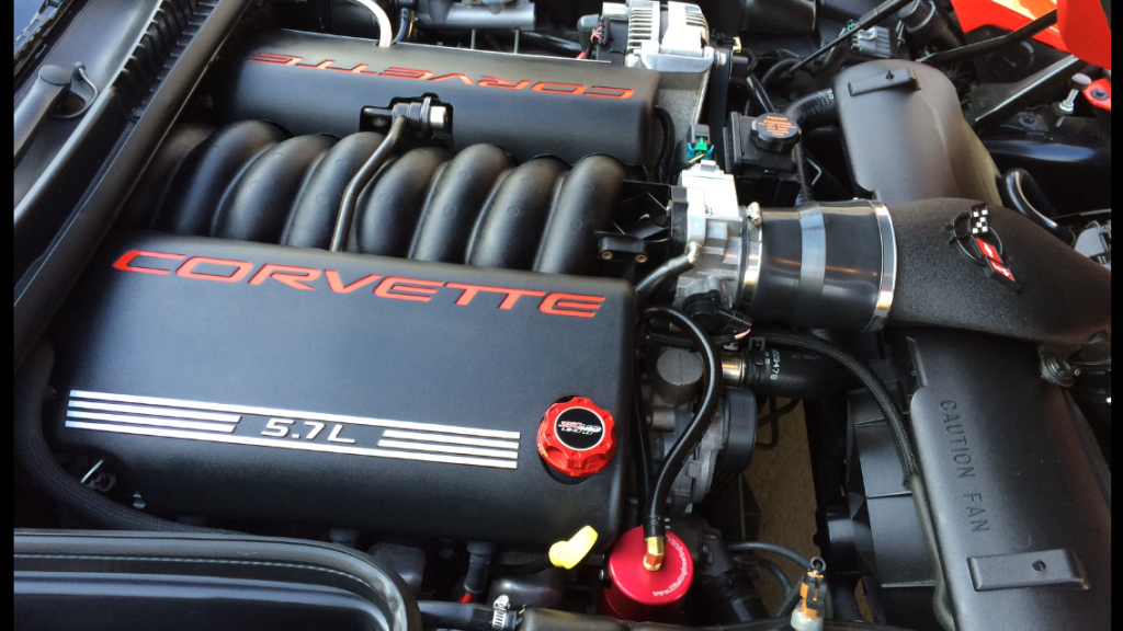

Clean Bay 1
Clean Bay 2
