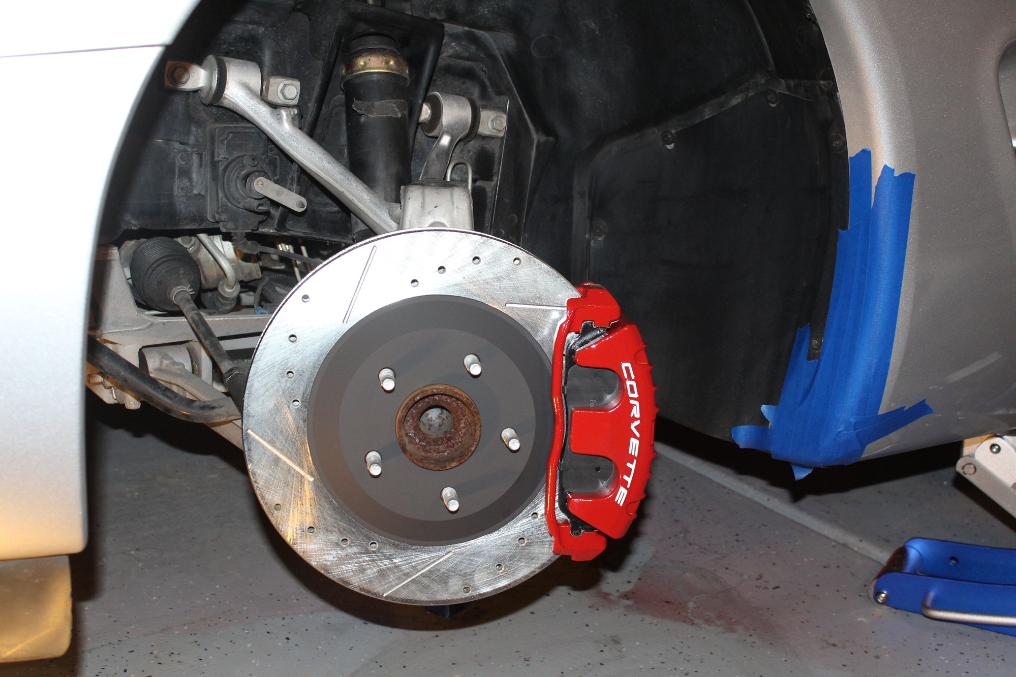

Where could I get some "corvette" caliper decals in black/white letters?

Your wife/girlfriend/sister's fingernail emery board works perfectly for that too. Being long and flat it makes the job a bit more even and smooth.
I would not use a decal from a sign shop. Likely they have no materiel that can take that heat.

I agree, just paint them, It's easier, cheaper, and longer lasting.

Not hard to paint the calipers (prep is the key) and removing the paint from the letters is really easy and looks great.

I hand painted my letters with enamel...

I dipped a piece of old t-shirt over my index finger, dipped it in thinner and wiped the paint off of the letters. Looks great.

Correct me if I'm wrong here, but I think the OP is looking to simply cover the lettering not paint the whole caliper.
If so, you can purchase a paint pen and just paint the lettering. Will adhere to caliper better and longer than a decal and if you don't like it, sand it off or choose a new color. Most craft stores will have these or get auto touch up paint.
