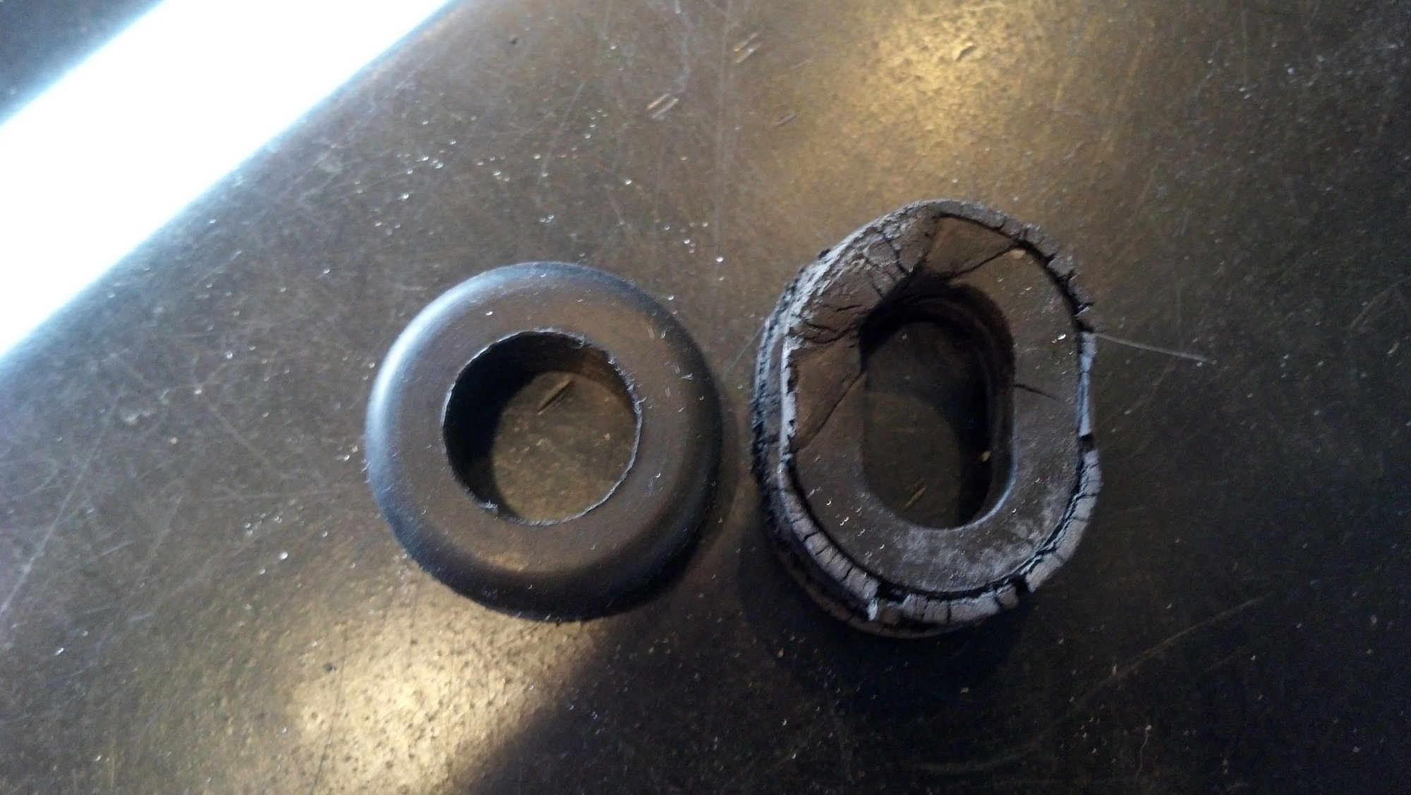

Well I got into the shifter alignment and noticed the rubber bushings were dry rotted. I suggest replacing them if doing a shifter alignment. Between the rubber bushings and the shifter alignment my 98's B&M shifter is much better.
What it looked like:
New vs Old:
Finished:
