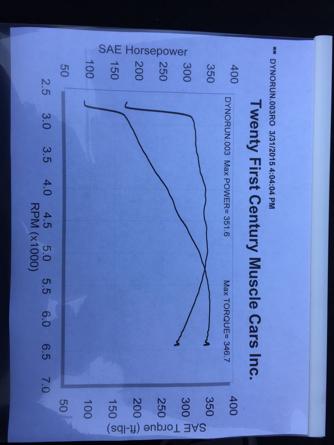

Well, the good news is I don't have a knock... The bad news is what I was hearing was detonation. Luckily, I got it tuned correctly and the car drives like a totally different machine. I don't know if I can say that I picked up a ton of rwhp, but the power is definitely smoother and more consistent over my entire RPM band (it keeps me in my seat instead of just throwing me back); whereas before it was much more a peak and valley feeing. Now, my torque curve is nearly flat from 2,500-6,400 RPM. All in all, the car put down 352 rwhp and 346 rwtq - I can't say I'm happy with the power, but I guess it could be worse. At least now I can get on it without worrying about blowing up my motor. Before the tune the guys said it was running very rich and with a huge timing advance, which was causing the detonation. If anything, glad I got it fixed. I attached some pictures of the dyno graph if you guys are interested.
