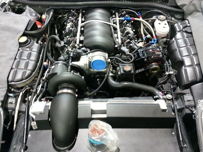

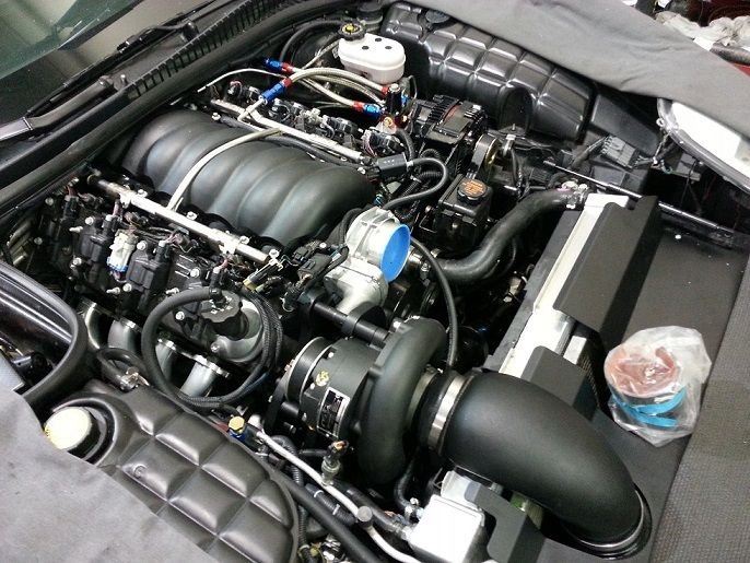

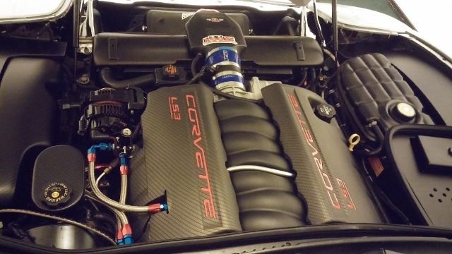

The car finally went into the shop this week as scheduled. The folks at County Corvette are great, James has been keeping me updated throughout. Since we are still waiting on the axles from RPM, they did the ATI HB and A&A SC install first. Wow!! For some reason, the LS3 looked tight in the C5 engine bay by itself. With the SC on, now it is really cramped in there. I'm waiting to see how the hood will fit, I'm guessing ok since these kits are meant to fit under a stock hood. My hood has slightly more clearance than a stock one so we'll see.
In the next few days they will get started on the drive train upgrades-mount the new diff, new McCleod RST Twin clutch, rebuild the torque tube with the new shaft and mount the brace and diff mount from HPDE. I hope by the time they are all done we get the axles and get everything done at once while its all apart. The good thing is, this is giving me a chance to repaint the garages at the house. I had always wanted to fix up the walls and floors.

looking good... much better with the blower on and fuel rail covers removed imo
Thanks, Im looking forward to getting it back. As for the rail covers, Im still debating whether to do a coil relication or put them back on. We'll see what the money looks like at the end of this.
I say go for it, the motor will look so much cleaner without so much clutter on top of it

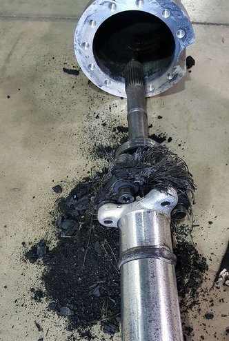

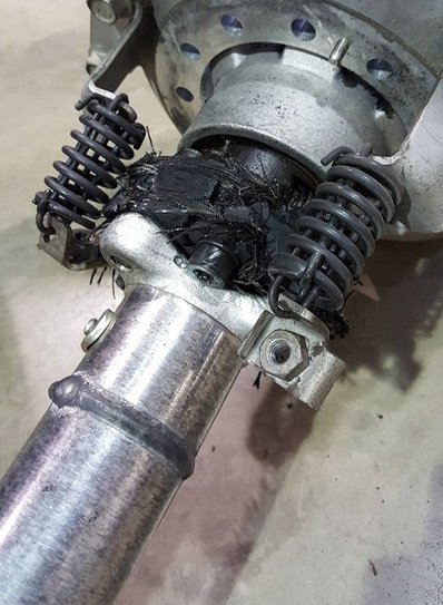

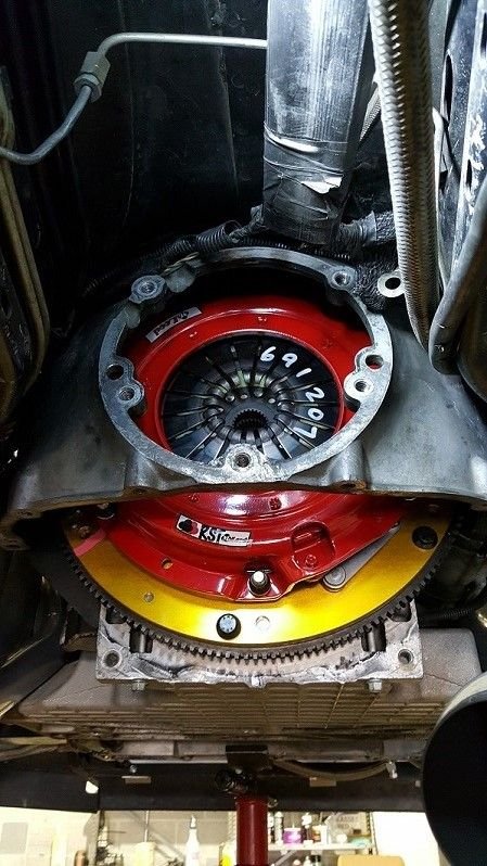

Well, the folks at County Corvette are moving right along with my car! The torque tube, tranny and rear end are all out. The McCleod RST Twin is going in, the torque tube rebuild is also started.
Boys and girls- take a look at these coupler and you tell me how much longer these would have had?
