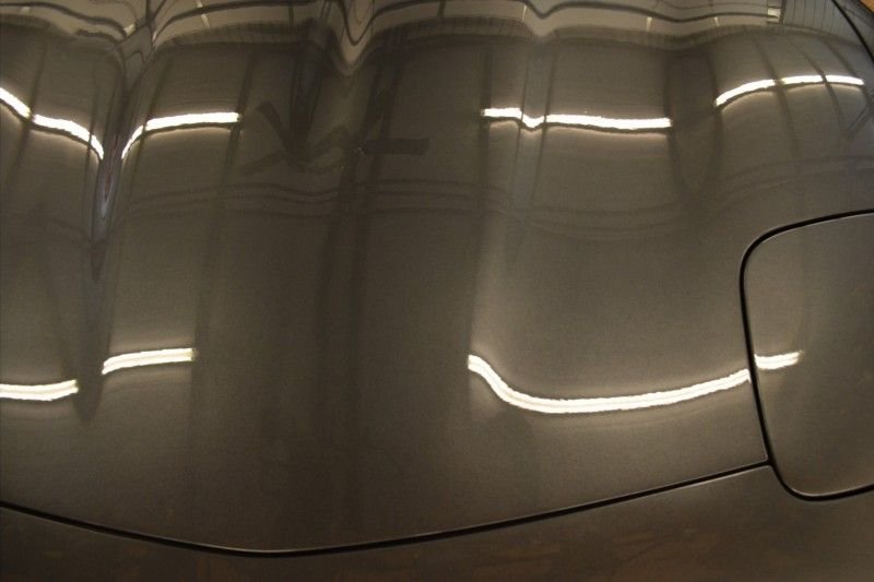

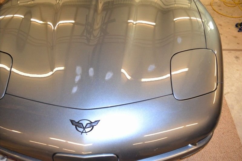

Well you probably guessed what happened...I met three running together so I slowed to about 30 mph and they were only doing about the same...
but when I got home I had 15 to 20 chips in the hood and that many in the windshield ... weird two in the trunk deck. Any how I went by one of best pros in town and he said....mmmm not much you can do...WTH!

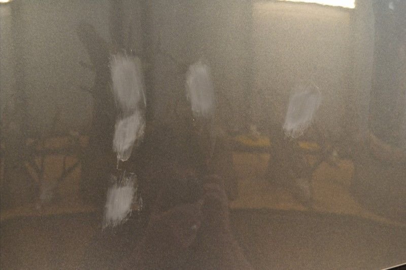

So, I decided I'd just do it myself....got some 1000 grit sand paper... a dab of clear coat... some wizards scratch remover and the buffer.
here is the part that's hardest to do....the prep and the aftermath of sanding off the top of the clearcoat blob looks about the same....I'll post some after pics..these are the last few I have to do....
I've got about an hour per chip......
But it's turning out really nice... you can't tell where I've fixed them...
obviously I still have to buff these spots out...

This method is working VERY well.... most are completely gone a couple you have to try hard to find them and couple that I need to sand and buff some more...it's slow and tedious..I don't want to go through the clear!!
The steps are simple...
Sand an area over the chip with 1000 grit
wipe it off with solvent
put a glob of clear on the chip with a toothpick or tiny brush...
let dry...sand off till level
buff with orbital buffer and a fine cut
polish...
re-sand, buff, polish, re-sand, buff, polish...etc you get the picture.

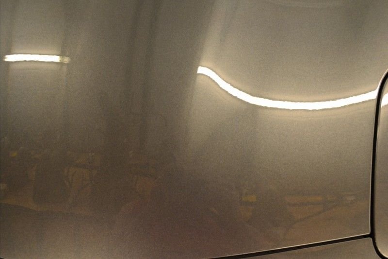

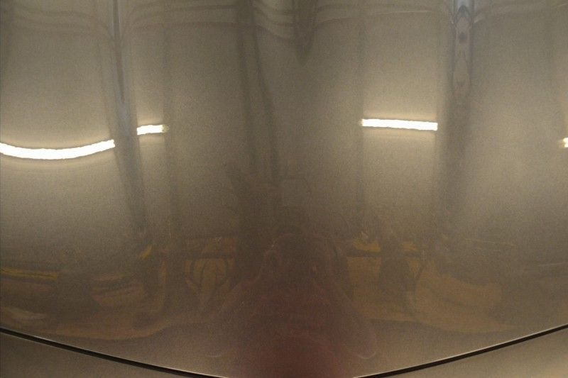

Finished buffing out chip repair
