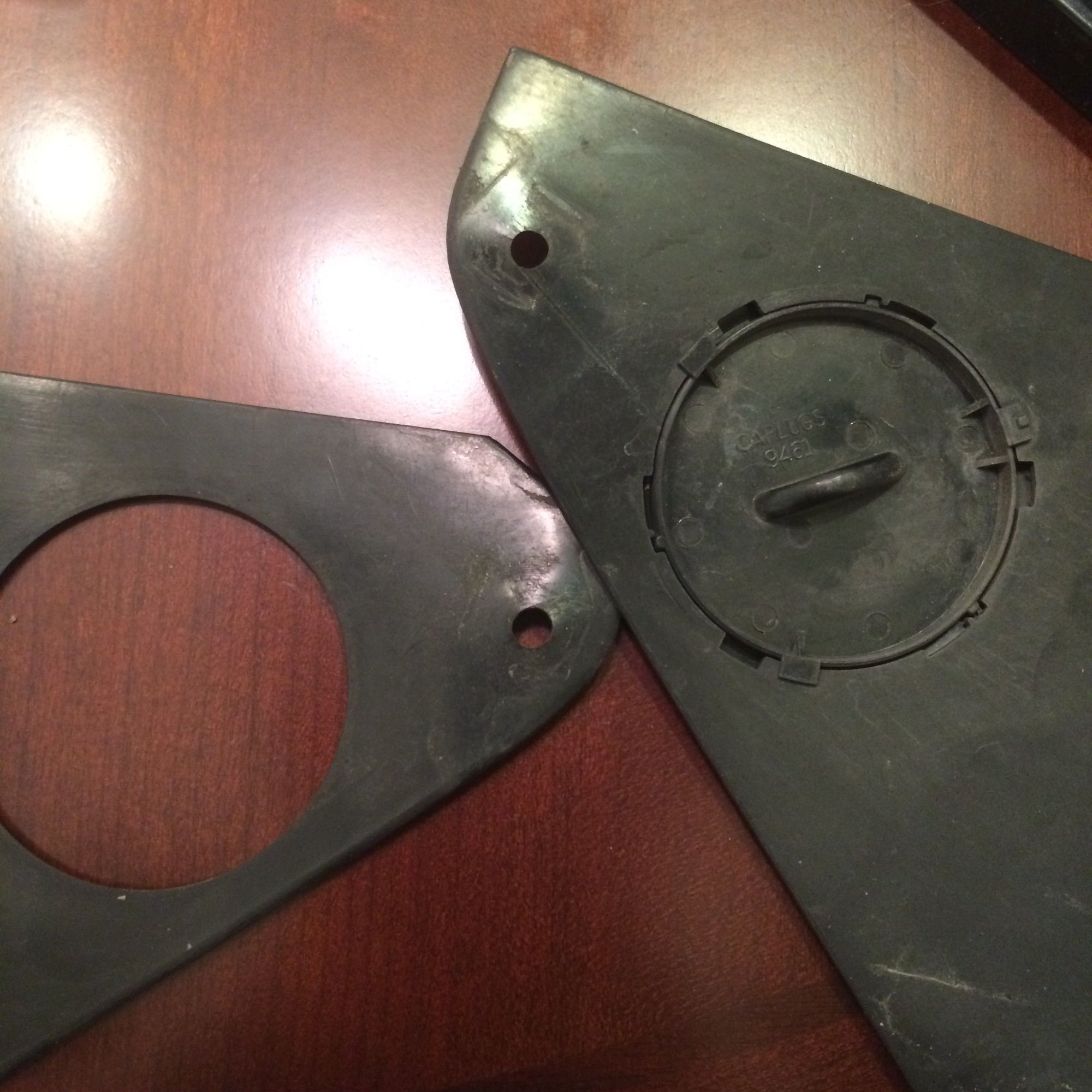

Went to add a new headlight plug I ordered and noticed the below. What the heck? Different headlight bezels?

With the original design headlight bezels, there were a lot of problems with the round plugs coming loose and flying off when you were going down the road. So, for the '01 model year they redesigned the bezel to use plugs that had locking tabs incorporated in them. Seemed to solve the problem of missing plugs - at least it did for me.

Thanks for the insight, I just super glued it on there for now since this one doesn't have the locking tabs.
