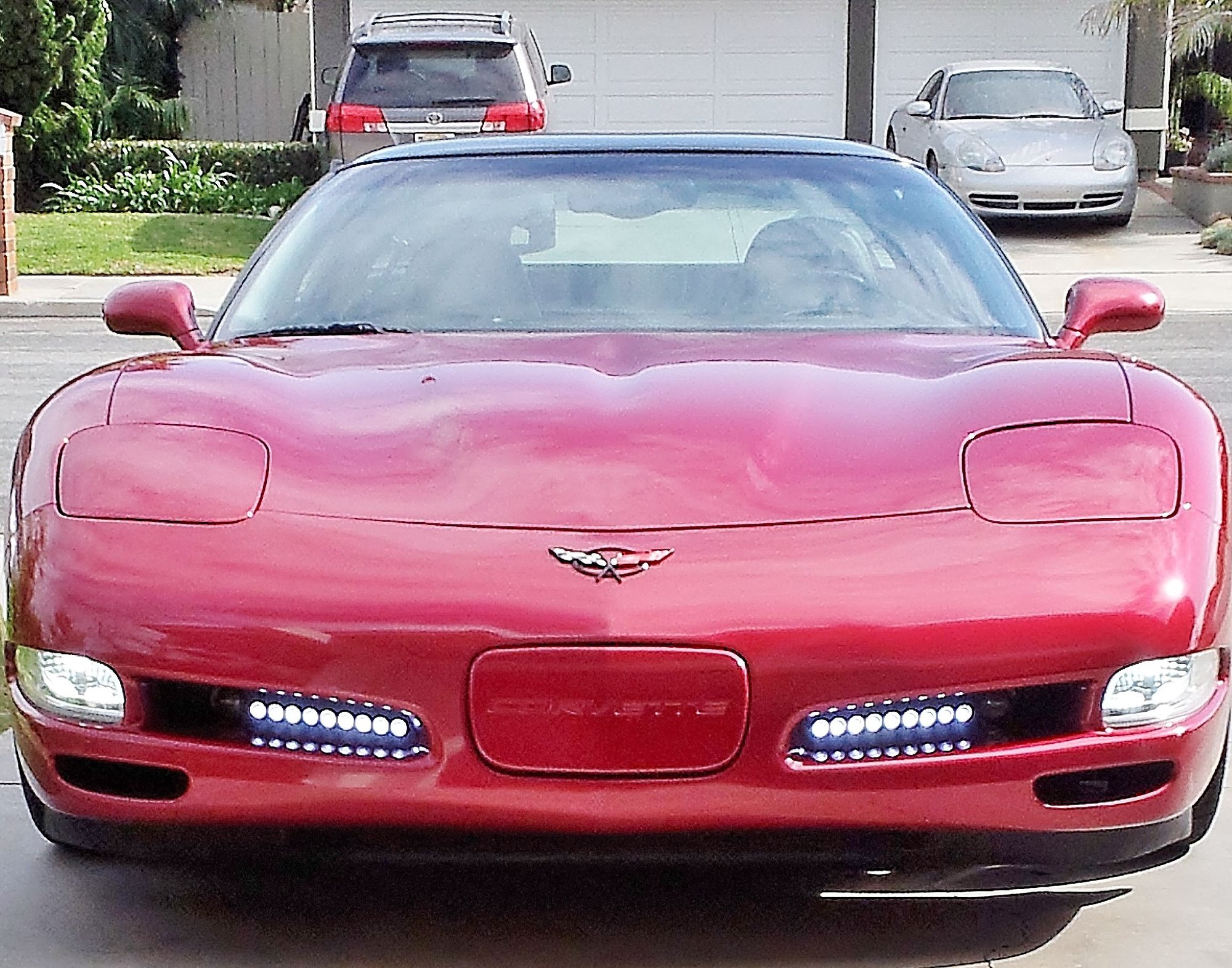

I recently installed a Curb Alert. Wish I had done this 14 years ago. Did they exist then? Anyway, I wasn't happy with the sensor mounted under the bumper so I put it inside the brake duct. I don't know if it will show but here's a pic...

Is it equally as effective there as the original location? I thought the sensor location was for maximum sensitivity to low curbs/objects.
Yes, curb/object height is not an issue at all. However, I was shocked at how narrow the horizontal window of detection actually is. The sensor only detects what is directly in front of it. I had read it could "see" about 15 degrees horizontally but in my experience, it's maybe 1 or 2 degrees.

It shows in the driver's side duct area. Hope it works well there.
How about some info on the LEDs in the fog light area?
