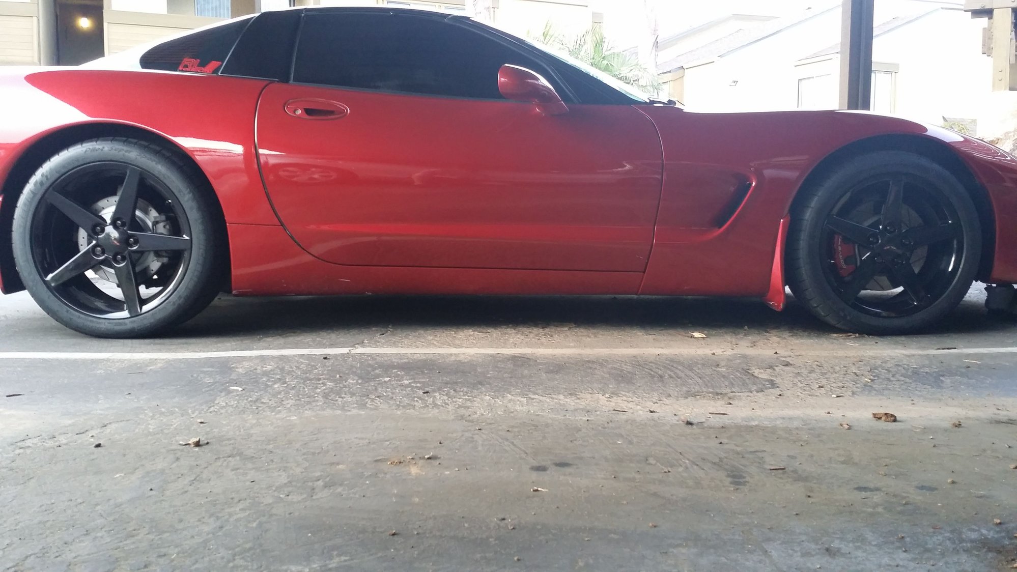

Finished installing the wheel spacers, didn't have to trim as much as I thought I was going to have to on the studs to the rotor, I'll get more pictures tomorrow after I get my new Michelin pilot super sports on was going to squeeze a 305 in the rear but it was to Damn expensive so I went with a 295..
Here's kinda a before picture, kinda dark but you can see the difference!

Got the new Michelin pilot super sports on today, what an upgrade from the Invos. Went with the 295 in the rear, no rubs, and also a 255 up front with no spacers, no rubs as well. Big thanks to MickVette (if you see this) for all the help, saved me alot of time and money!

Here's some quick shots for anyone that is curious or is interest in what my set up looks like.
295/35/19 Rear with the 20mm spacer
255/40/18 Front with no spacer
