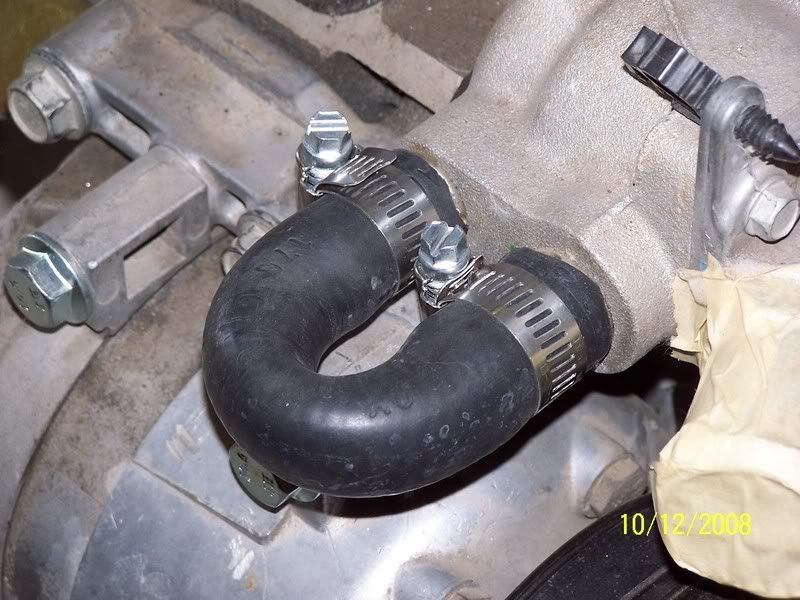

This look likes a LS type water pump.

ok here are the pics i promised. THe hope is that this helps someone else whether its temporary or a permanent fix.
As you can see in the first pic one of the coolant lines comes right off the water pump area to the over flow tank, then off to the heater core
This picture shows the heater core inlet and outlet. Hard to see but I put rubber stops and wrapped it in electrical tape for the time being
Lastly this is the 3/4inch 90 degree adapter I bought at Lowes for a few bucks. Fit snugly and the clamps tightly grasped it. So far no leaks but if it does i'll probably buy some better clamps if it does indeed leak.
