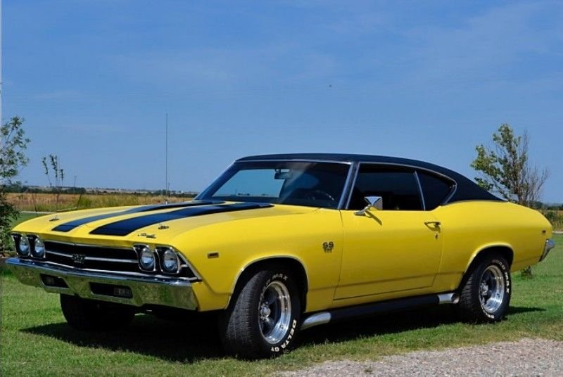

Have you looked under your car... there is no "slapping on" side pipes.
I'm sure it could even be done, with serious modifications.
I wanted them on my Chevelle and had never seen any that I thought looked nice... so I built my own... one of the nicest compliments I've gotten was a guy asked if they were factory.. I LOVE them.... 36 inch glass pacs behind the shields full 3" exhaust. ceramic coated the inlets and outlets Hooker ceramic coated headers... they sound amazing on the hiway at 70 mph

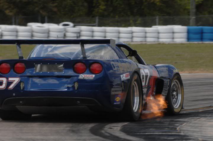

Pratt & Miller did it...

Those two pictures make the side exhaust exit through the rear fenders some people have done seem almost like a good idea....

Looks like you did a great job, but don't those hurt your ground clearance?

Not at all... I made the shields out of 4" exhaust tubing and painted them with John Deere muffler paint... you can get off the interstate and lay your hand on them...they are warm... but not hot enough to burn you.

Pratt & Miller did it because it's functionally better if you're running real aerodynamics. A true diffuser would trap the exhaust pipes inside the air flow with the transmission and the differential. Re-routing the exhaust out the side makes it easier to cool the diff and trans
