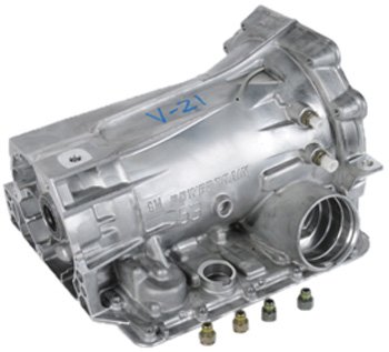

Options:
New GM case "Kit" 24231450 $465.xx
Call Marc at vettenuts for a good used trans assembly
Call Rick RKT56 for either a rebuilt assy or maybe he has a case he can sell.
