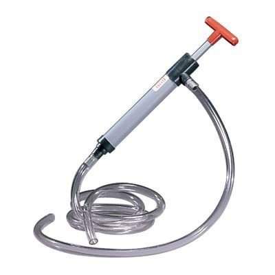

You should be able to get a lot out with a siphon pump.

JR- I tried a pump like that and could not get the hose more than about 12" in. There's a pretty sharp 90 degreeish angle I couldn't get the hose to advance past.
Good to know.
