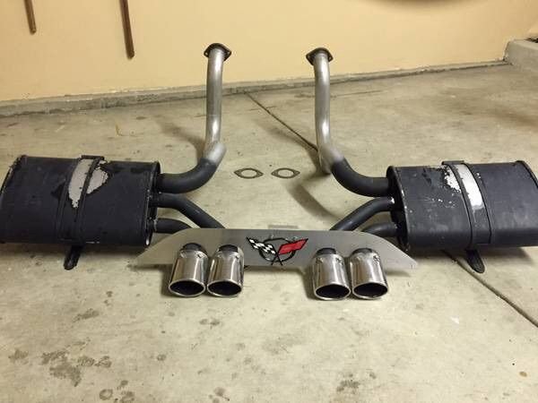

I'm trying to find a cheap fix for my son. He is trying to buy a house ad doesn't want to spend a lot right now. Found a pair in Chicago and I live in Milwaukee, 2 hour drive). He says they are off a1998 but they have chrome tips. Did he add the tips? Just wat to be sure they will bolt up.

They will bolt up. Every thing is the same as far as mounting points. You will need to get the car up on a lift in order to work the pipes up over the rear axles. Removing the rear sway bar will greatly aide in removal and installation as well.

these are the mufflers I am trying to put on a 2004.they are off a 1998 and the must have added the chrome caps. Will these bolt up toa2004????
Yes. It just seems they added chrome tips to look better.

Yes

Yes they will mount up. They are displayed in the photo wrong. They are upside down and left is on the right and visa versa.
