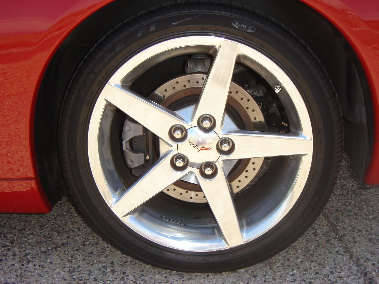

Drilled rotors were never offered on the C5 from the factory as 8VETTE7 mentioned. They were offered on the C6 Z51 models.
starting with the C6 released in Sept. 2004 - - photo from my Precision Red `05.
