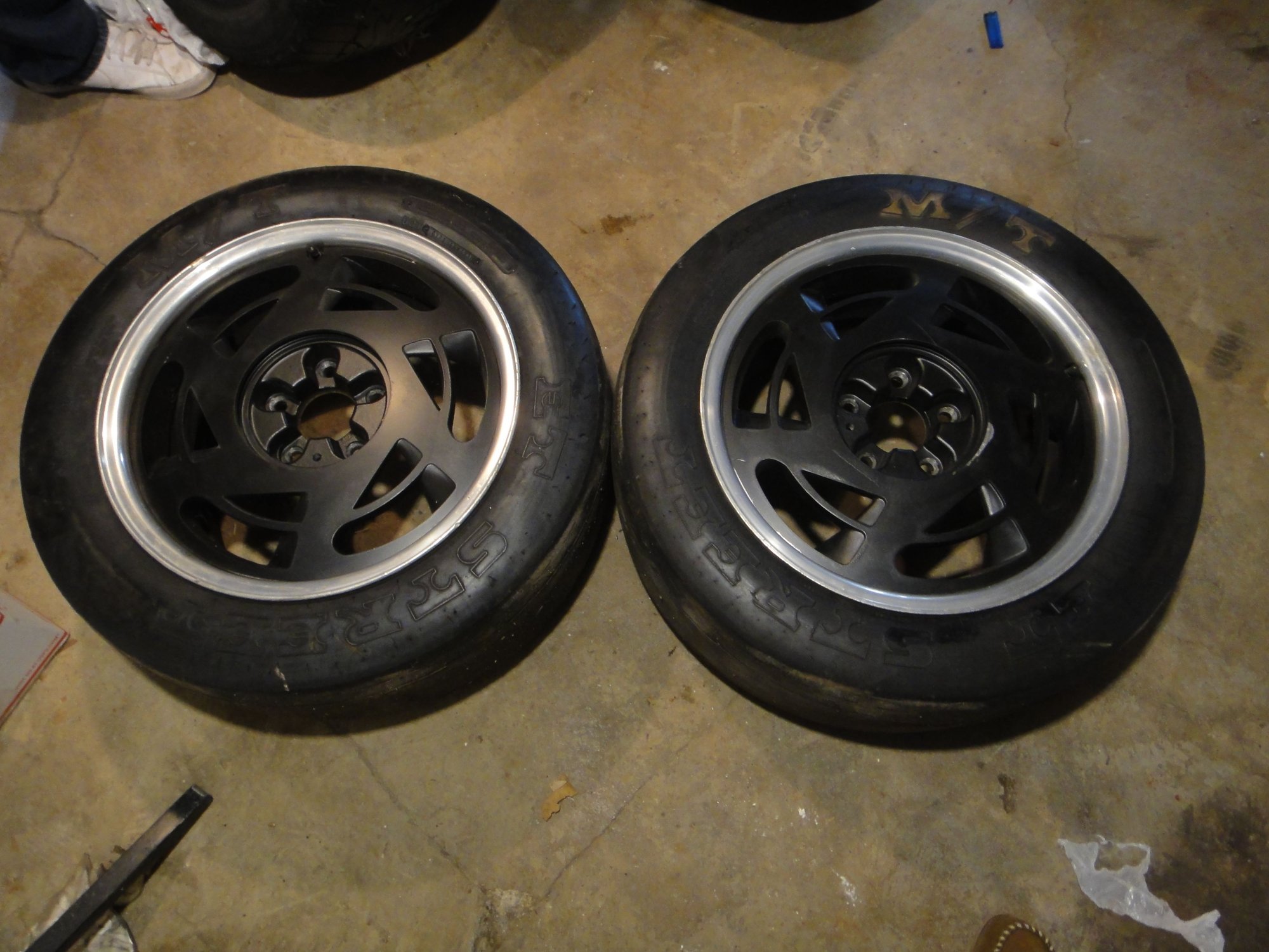

it is simple to do! you just need to clean the wheels really good then apply 3 to 5 coats of plasti dip, you want to spray heavy wet coats but not heavy enough that it runs (apply next coat before the last is completely dry) or you will get a textured finish (I learned the hard way) the more coats the easier it will peel off
tips:
if you masked off any thing you'll want to remove the tape while the plasti dip is still wet, once it drys if you pull the tape your going to pull up the plasti dip from the part you want it on too
if you try to remove it and it dont come off easy, spray a citrous based cleaner on it let it soak 10 minutes then soak them again for another 5 minutes and power wash it off
over all its pretty easy i've done 5 sets of wheels and other car parts, when its applied right it lasts till you peel it I've power wash my wheels with out any peeling every time it got washed
these wheels are dipped
