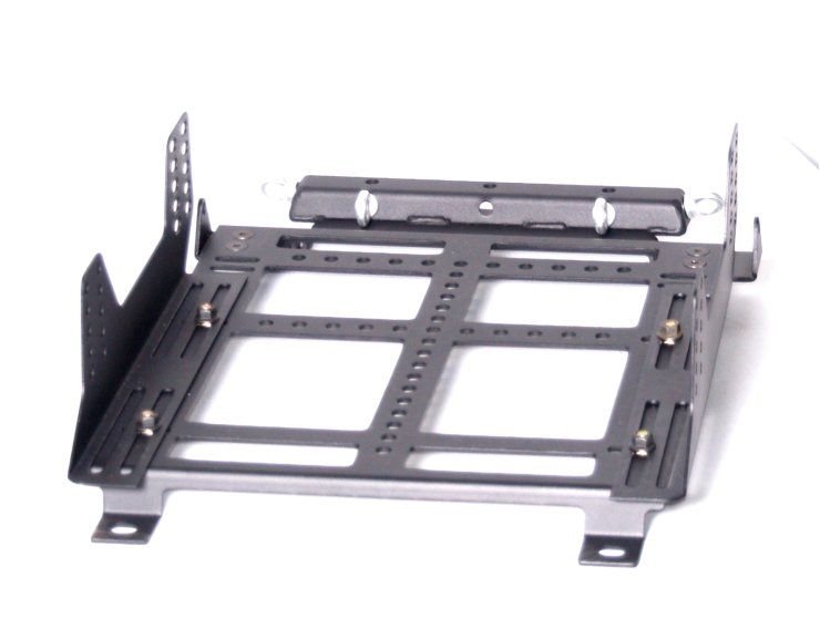

I made a video on my phone to show the adjustability of the brackets that were used.
http://www.marradind.com/C5_C6_Seat_Base.mp4
The picture below shows a bracket without the seat. You can see the slots in the side mounts. After you position your seat in the car, pull the seat, remove it from the brackets and add some holes for grade 8 bolts at the end of the slots. Two holes at the front end of slots and two holes at the rear end of slots is good if possible.
