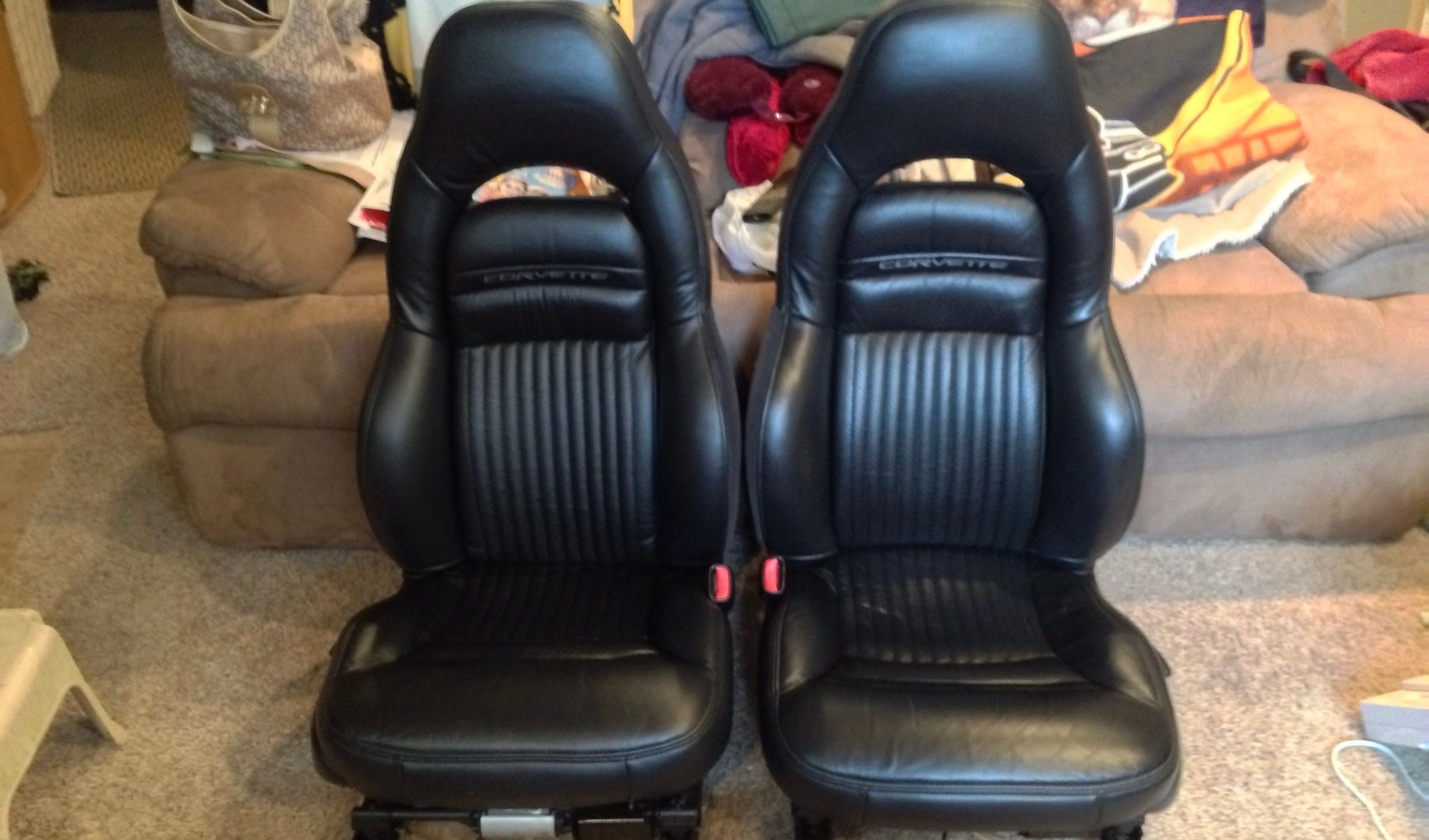

the C5 seats remind me of old catchers mitts

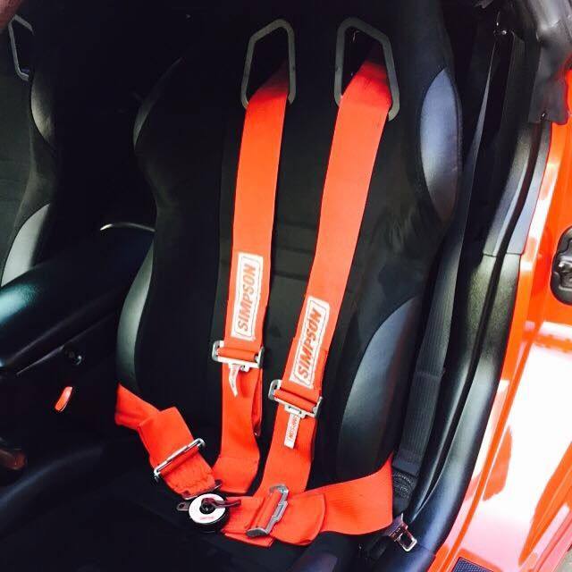

C5Z seats suck lol this is what I went to. Corbeau A4

I guess those are nicer.

I think so, feel and look much better.

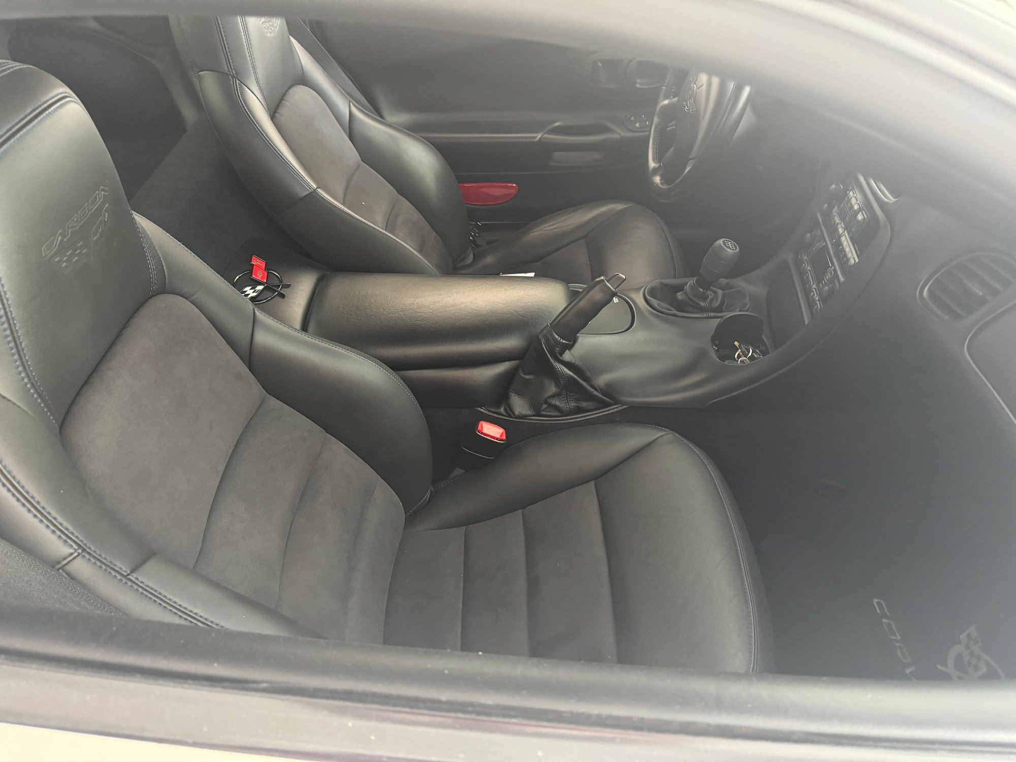

I found a set of seats from a C6 Carbon. Not a great seat from a performance standpoint but they look 100% better
anything is better than a stock C5Z seat

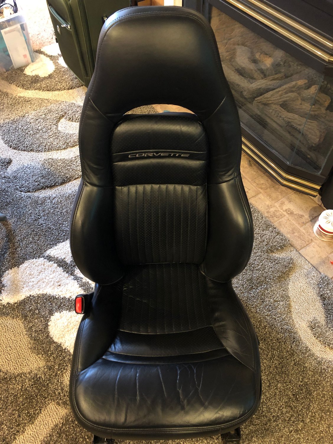

It’s always entertaining to me how badly C5 seats are poopooed until it’s time to list them for sale!
