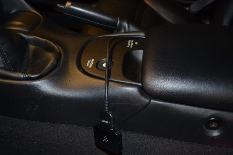

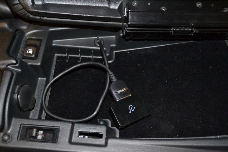

IF... you have the 10 disc changer then all you need...Peripheral PXDP PXHGM4 Chevrolet Corvette 97-04 iPod Adapter its a plug and play for your Ipod or Smart Phone... then you can get a Aluratek - 30-Pin Bluetooth Audio Receiver from Best Buy and plug into your IPOD adapter for hands free Bluetooth....
Pics of my install
I usually just keep the Bluetooth Receiver IN the console... everything looks stock and runs through the stock radio...
IF you don't have the 10disc CD change you can do the same thing but, you still have to REMOVE the radio to plug in the adapter...
SO now I can play CD's, Radio, Ipod, I phone/Pandora, Bluetooth....
By the way... the UPGRADED Kicker speakers I bought from DENNIS made a significant difference in sound quality... they are plug and play as well.... GOOD LISTENING
