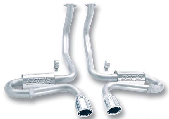

Originally Posted by jptgs1
So I'll assume your exhaust is the issue? Do you know what brand it is, that would help!
Yes, exhaust. Borla Stinger cat back.

You have an A4? Tune helped my Stinger drone immensely. Would love to hear what a tune and xpipe sounded like together.

Your exhaust is the culprit.
I had the exact same one..it was a nightmare.
Now I have a Borla ATAK...ZERO drone...I also added a sound killer partition..
I have long tube LG super pros, 3" catless Xpipe...a decent sized cam...ZERO DRONE...
I am extremely satisfied.
Known for drone indeed
I like Corsa's as the fix
Sell off the old locally like Craigslist...get the new
Or If you like the sound, replace it with a newer set of stingers. The older ones droned but the newer ones have been redesigned. Corsa makes a v8 sound too much like a flat 6

I have a set of the 4 tip stingers and they drone but I don't think it's that bad. It only gets annoying on longer trips.
OP, if you end up going the route of the x-pipe let us know how it works out for you. Thanks.
