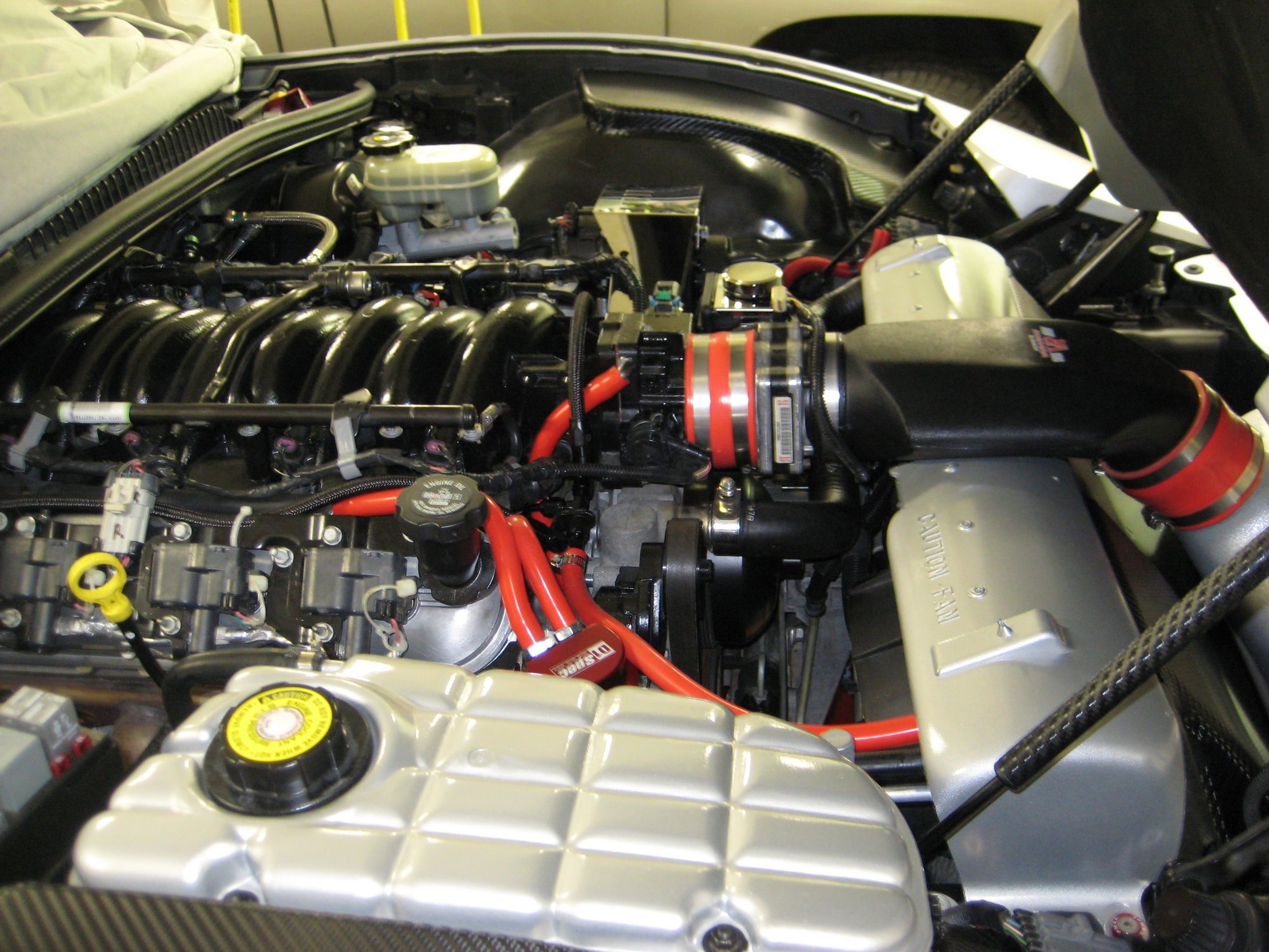

Hi folks I am going to install my power duct this weekend. I would greatly appreciate if a 97-00 owner who had one installed could reply with a pic of the air bridge where you have the MAF installed. Just want to get it right the first
time. Thanks in advance.

Here you go !!!

Here's an 04, hope it helps!
the maf goes bellow I think
am i right ?

Pictured is a '97 with MAF in original location.
I had posted here on the forum asking what to do with the piece being held in the photo (there was a hole for it in the original accordion style coupler). I forget the details, but this piece was only on early C5s and was not necessary to reinstall.
