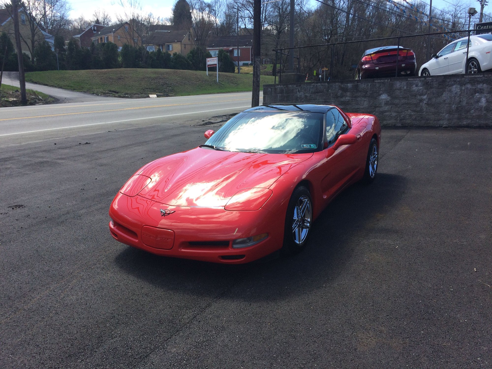

I don't know a thing about any junkman. What i do know is some of what you have heard is not correct. The clear on these car are water base. I would not use anything abrasive or harsh. There are a lot of fine products that can be used on these cars. I prefer to use a polish. Zanio in what i like. they have a lot of different options that you can use to improve your paints finish. This car is 17 years old with 45000 miles, I am the original owner. Doing your car is not rocket science, don't over think it.

Zaino.
