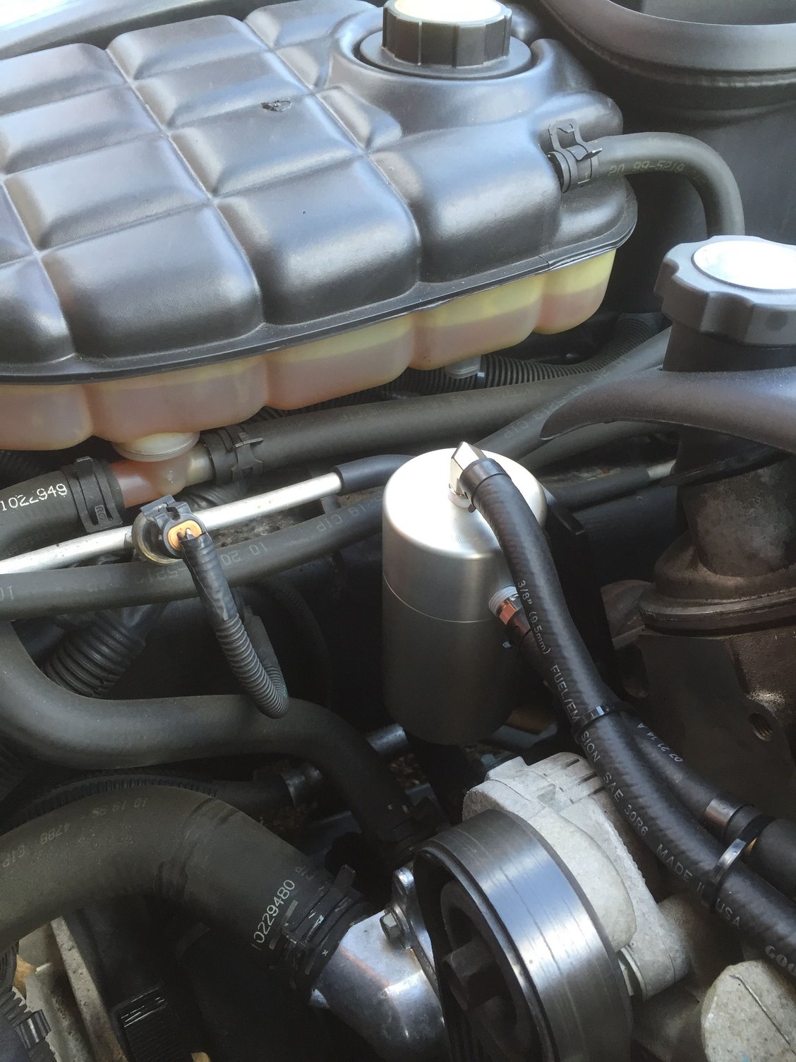

Doug explained that my car is pinging bad even after a sea foam. He's going to top it up with premium and see if perhaps it's something with my gas. He showed me the readings he's using EFI live.
A few new clients
My addition to the custom license plate list
Nice install on the LSX catch-can - a well-made piece!
