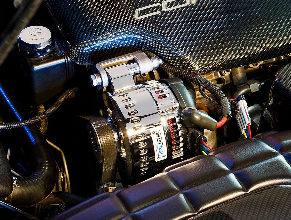

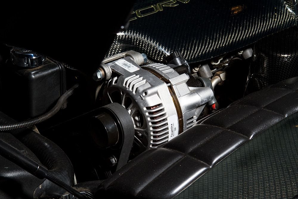

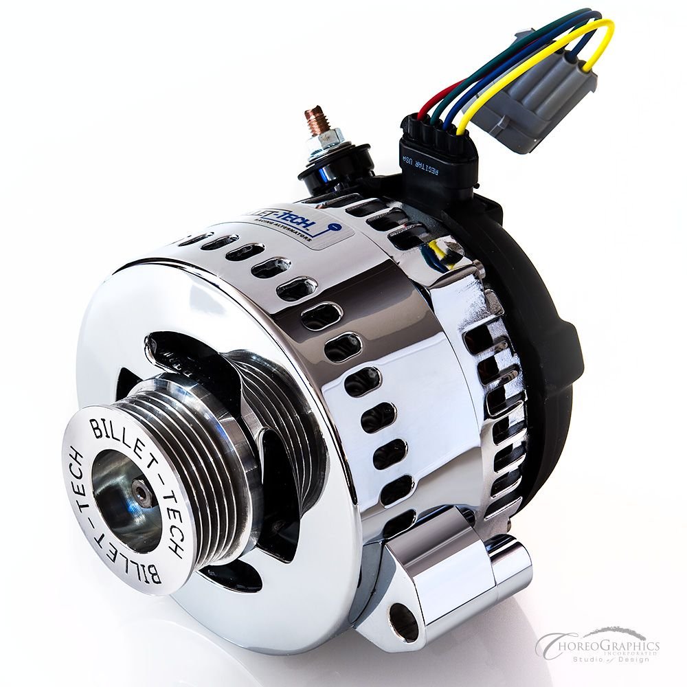

Only time I ever saw that was when I had to swap my alternator. Took 3 new alternators to get rid of it. No problems since finding one it liked.
I REALLY liked this high-end alternator, but my C5 did not like it...
Finally found a remanufactured one that it liked...
