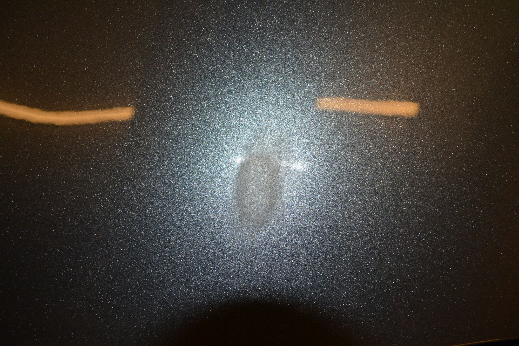

Originally Posted by laurent_zo6
Clear comes in what form?
I tried finding a shop that would let me get some small portions...didn't get much help... and NOBODY wanted to mess with fixing the chips..
So, I got a rattle can of enamel and sprayed some in the cap... took a toothpick and blobbed it in the prepped chip... sand, blob, sand blob till it was nice and flush and then buffed, polished, and waxed... took several apps to get it to where you can't tell I ever had a chip...
these are the products I used to do my chip repair, and it worked for me...
I did about 20 of these chips on the hood... this way
I tried to JUST take off the blob and NOT sand any deeper than the original clear coat deepth... which is impossible... so, I tried to take as LITTLE as possible off while sanding to flatten and feather the blob... to make it disappear... good lighting and lots of patience required.
I used 1500 grit sandpaper and the wizards compound... you can actually use the compound on a rag and your finger to buff enough to see if you have the chip filled or not....
When I say sand... it's really more of a scuff... VERY VERY lightly... tiny removal at a time...
Final results...
