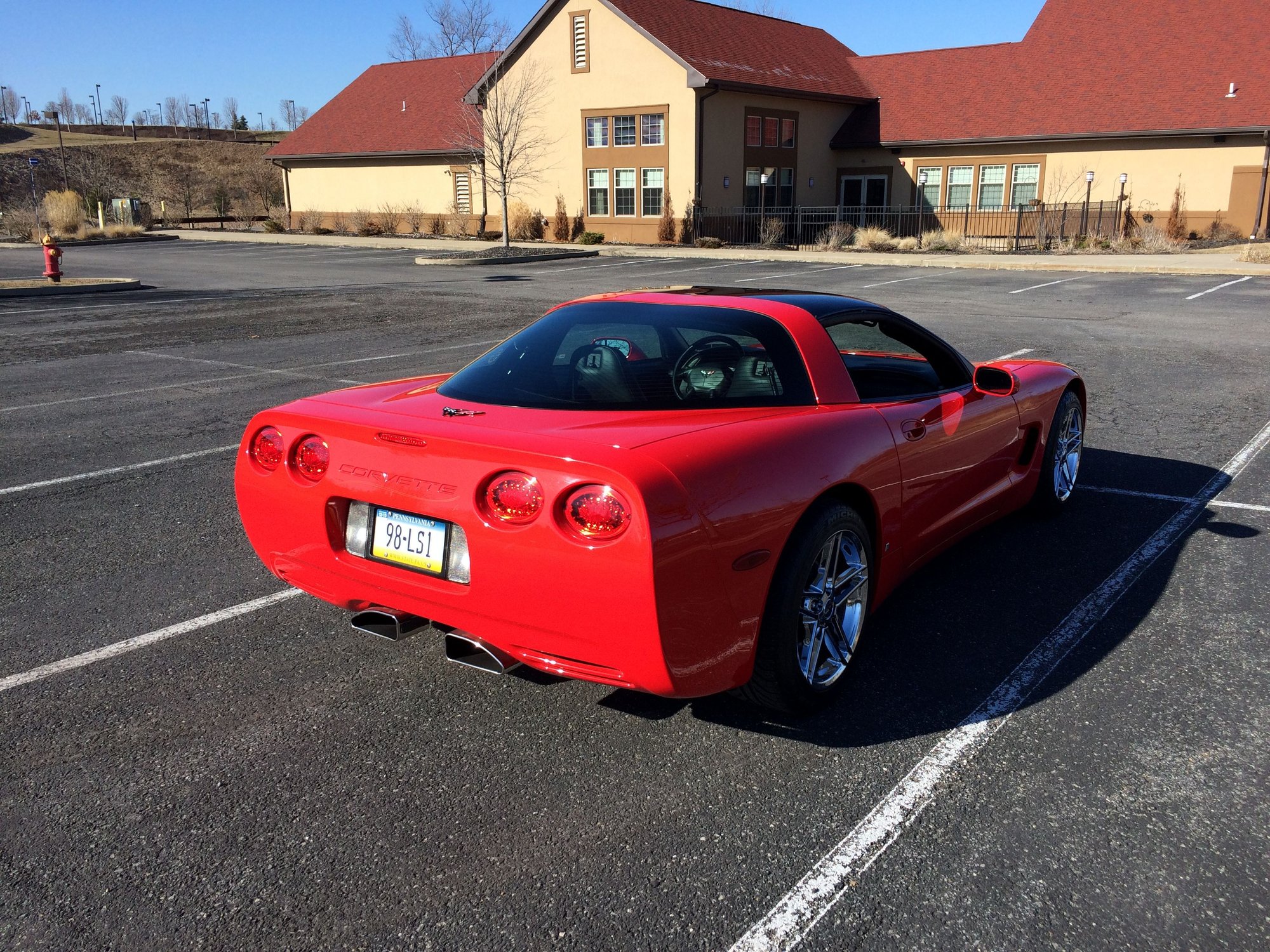

As long as they were put on the position they came off of, no need to reset. As for the chrome, No chrome polish needed on new wheels. I don't use anything on the wheels that i would not use on the car finish. These wheels have been on my car for 7 years and still in great shape. I use the same polish that i do on the car.
