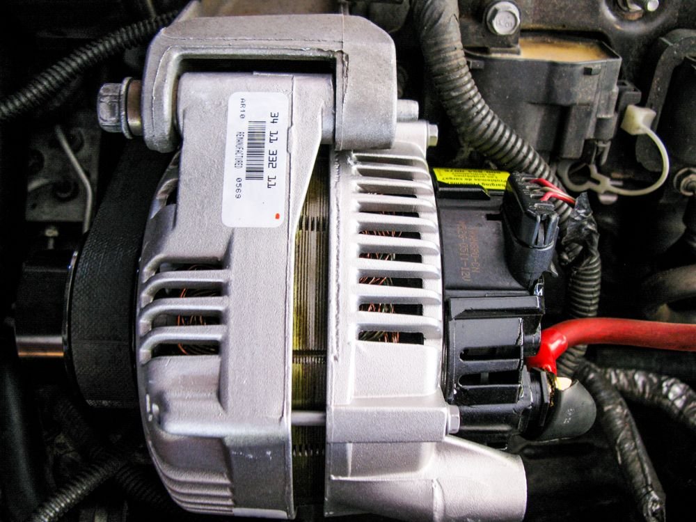

choreo, how long ago did you buy the billet tech?... I'm just wondering if it has been awhile and maybe they have made some advances since then that we are not aware of?... mine is pretty new but like I said I have had zero issues with it, no charge faults/revving to 2k/vibration/etc... if it matters at all my car is an 02z
It has been about 3 years and BT was very good about issuing a full refund.
Mine is a 2001 Coupe Auto. As I understand the early C5 Autos had solid alternator pulleys (as did the manuals) on the stock alternators, but due to repeated customer complaints about the drive belt causing vibration when putting the car into gear, GM decided to swap out the solid pulleys for the decoupler pulleys (i.e. pulley with a sort of clutch mechanism) on all automatics after a short period of time. By the time I bought my 2001 auto, all autos had decouplers and the vibration problem was solved.
When I installed the BT, it felt like the car was falling apart when I put it in gear (from Park) most of the time - there is no way that could be easy on the belt system and the tensioner was going crazy trying to compensate.
When I bought the BT, I was not really too concerned about the additional power output (although that would have been a plus), I was mainly looking for a high quality "reliable" alternator for "my" car and made the incorrect assumption that it would naturally be "compatible" as the C5 had been out for years with plenty of time to test them. I did not see any complaints with BT in the C5 in my research, and even called them in advance prior to placing the order to confirm that they had tested it in C5 Autos. Following my nightmare, I was never able to locate another C5 Auto owner that could confirm that the were able to get it to work.
I finally resorted to installing three different O'Reilly's stock replacements of which only one proved to be compatible, but the case cracked 6 months afterward. The other two were causing the DiC to light up like a Christmas Tree upon installation. In desperation (since this is my DD) I did a Hail Mary and ordered a Tough-One from Auto-Zone (cheapest of the bunch) - it fired right up and used it every day for 3 years without ANY issues (yet). I kept my stock Valeo with the burned out decoupler, but after several phone calls to various alternator "experts" none of them were very convincing to me that they really would be reliable in rebuilding my unit and ALL of them insisted on rebuilding with a solid pulley.
My current alternator - not nearly as "pretty" as the BT, but it not only works, but I have had consistent dash voltage readings above 14V for 3 years now and I did not even get that consistency out of the 2 stock Valeos I had!

As stated. I was not in need of an argument. Didn't need the "been there done that or the here we go again comments".
I am very greatful for all the information I get from this forum. That is why I decided to become an annual member instead of a lifetime member. So o can contribute yearly and not just once. I don't get paid to be here. But people like myself asking these dumb questions keep this forum alive.
No harm was aimed at anyone. I do want to thank those who posted pictures of the product. As well as solutions.
Solutions are needed, and who cares about the moon. Jk.
