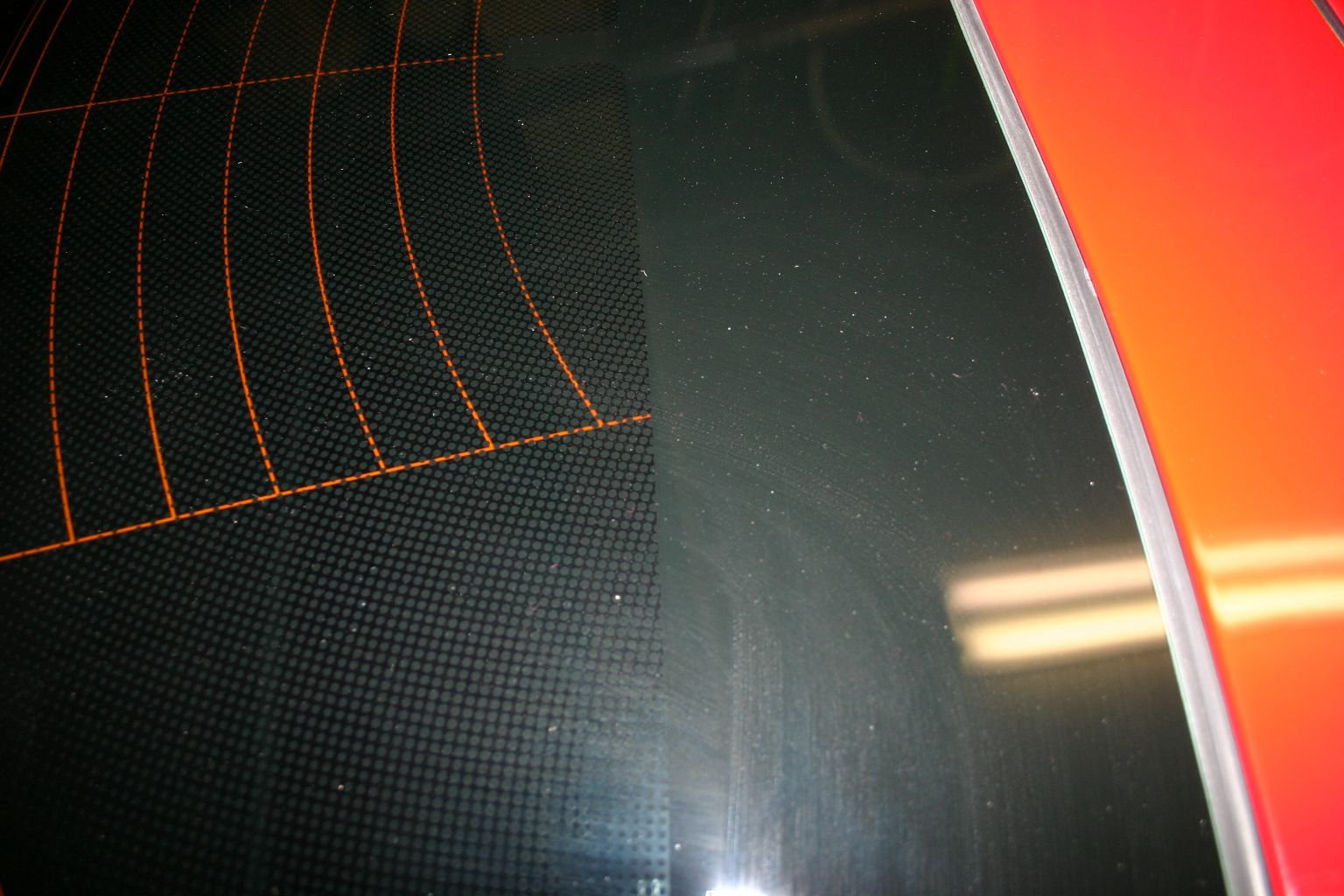

I recently had the back window and door windows tinted. I'm noticing that on the back window toward the top section where all the small dots are, the tint is not adhered to the window like the plain glass area. Is this normal? I know the rear window is very difficult to tint. From in the car you don't see anything as bubbles, etc. but from the outside, if you look closely you'll see it. Should I take it back to the tint guy? Any advice? I know the pic is hard to see but if you look at the middle lower portion of the pic, you can get an idea was I'm talking about.

I would say "Common" vs "Normal".
Some tint shops will sand the dot-matrix down to lessen the effect of air bubbles forming, but in my case after two tint jobs, I went ahead and painted that area on the inside with black Krylon Glass Paint and that got rid of my problem.

there is an adhesive they can use that will help the tint stick to the dot matrix but the best solution in my opinion is to get some vinyl and have them cover the matrix... it will be completely black so you won't see the dots anymore and it will blend in with the edge of the window

.. the best solution in my opinion is to get some vinyl and have them cover the matrix... it will be completely black so you won't see the dots anymore and it will blend in with the edge of the window
That's how mine was done. With the hatch open it looks like a huge area blacked out, but with it closed looking back I never even notice it.

I bought magoops for the dot matrix. Still have not tinted mine so have not used it. Your supposed to put a bead on the edge then squeegee it similar to what you do when tinting. It removes the air between the dots so it looks like the rest of the window. Otherwise I've been told that vinyl is the way to go.

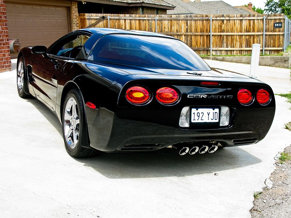

This photo gives you some idea of what mine looks like painted from the inside with Krylon black glass paint...
To base coupe window tint
