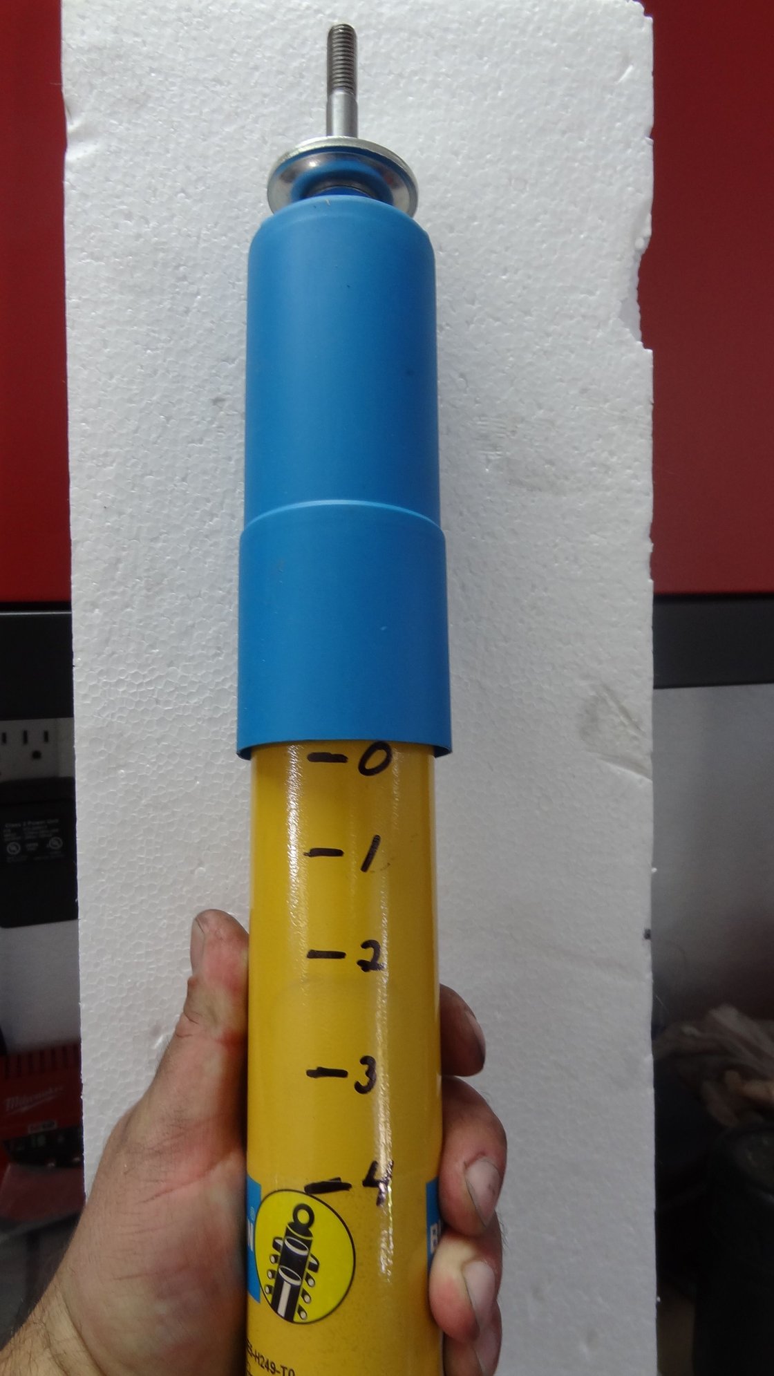

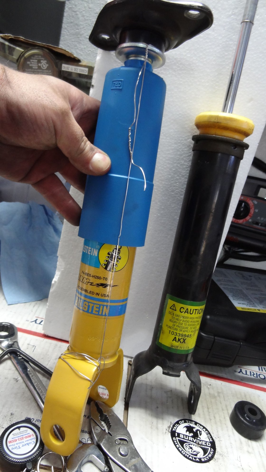

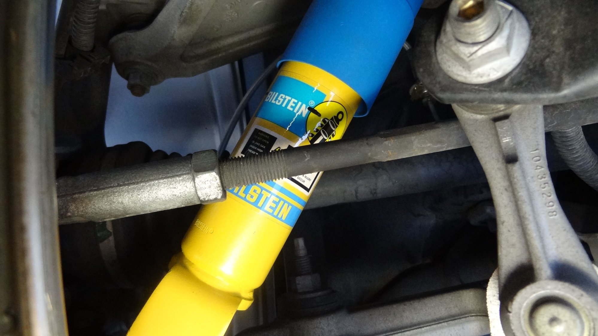

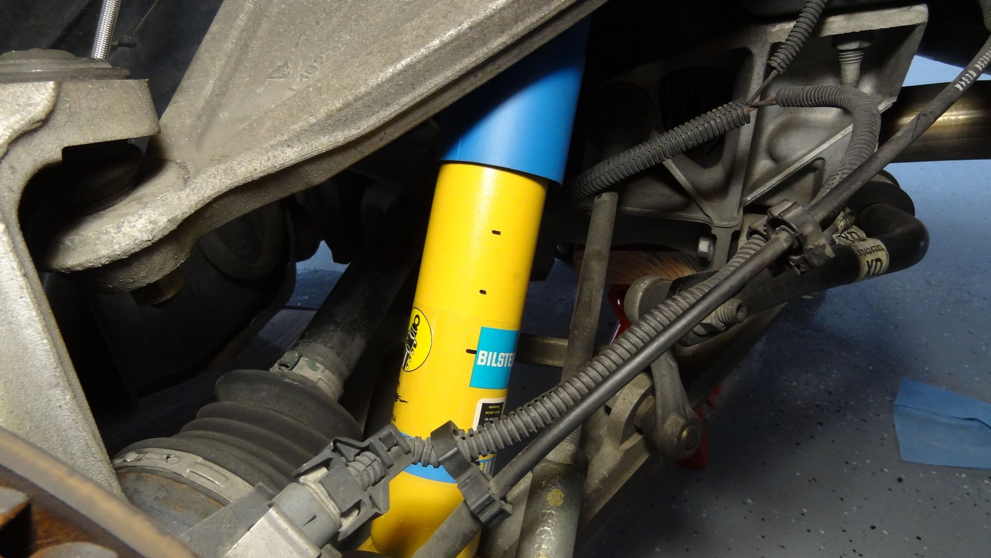

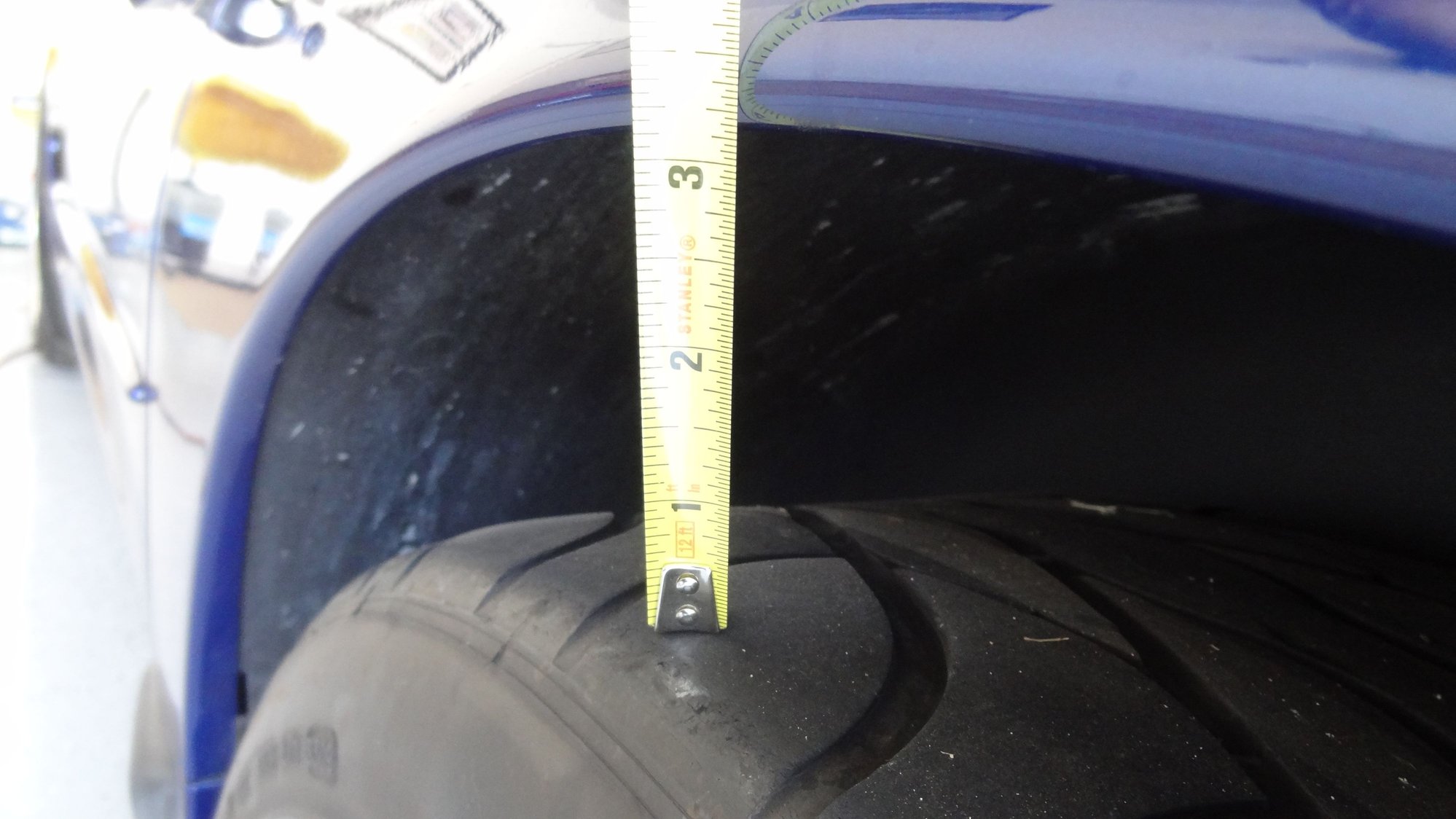

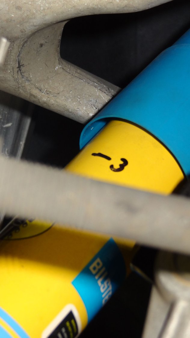

Here are the photos I took when I replaced all shocks. Mt Z06 is at stock ride height.
Front
Rear
