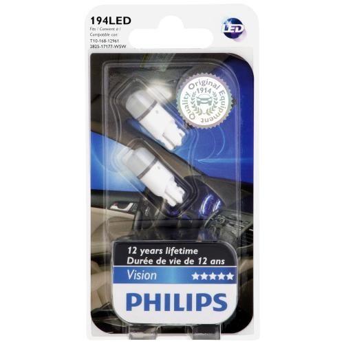

Default shifter indicator bulb
I used a Philips 194 I bought locally at auto supply. It is a compact and nice looking bulb and is really bright. I just bought a package of one and it was $8.00. Hope this helps.
