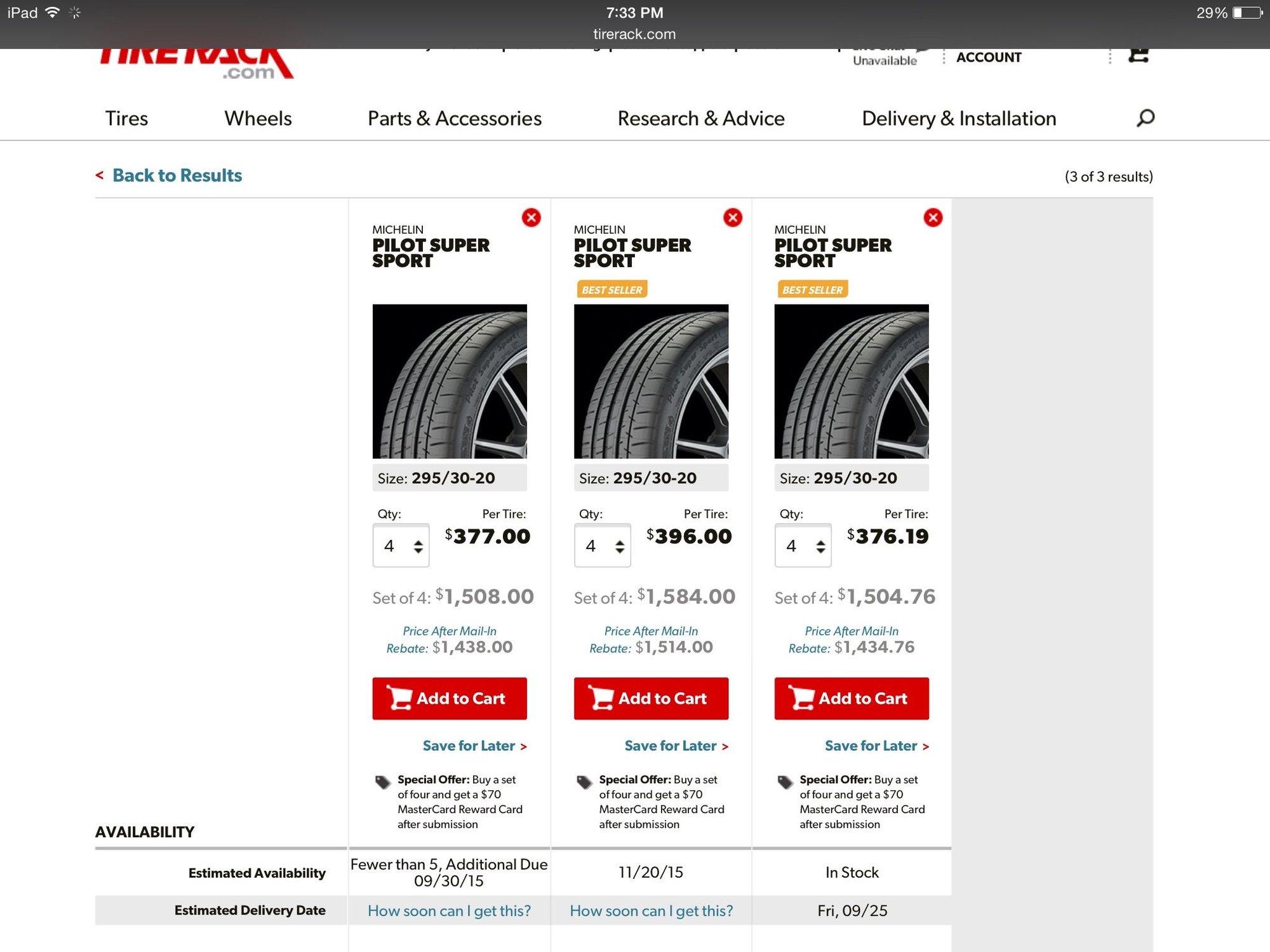

This shows exactly what I was talking about, 295/30R20 Michelin Pilot Super Sport, all the same size and manufacturer but three different tread widths. The two tires will definitely look wider than the one but the other two the difference is so small you wouldn't notice it. 11.5 inches wide is pretty wide for a 295 tire, it actually has the same tread width as the PSS in 315/35R20.

I agonized over the tread width issue before and after the purchase. There is no clear cut part #. Who is to say the guy in the warehouse ships any 295-30-20 he feels like. For the rears, I purchased the 11.5 tread width version.
You will find the same issue with the fronts. I purchased the Porsche version.

That's the one I want, the 11.5 version. No part number is going to make it interesting.
