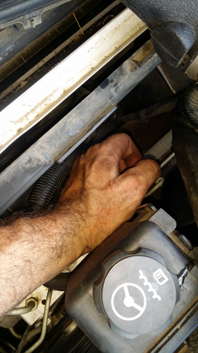

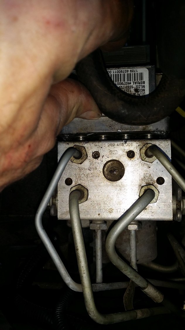

I got on here and read a good thread describing how to change the module out. I bought a brand new one sealed never opened. I plan on getting the old looked at and repaired.
This job is an absolute nightmare for me like most repairs on either of my Corvette's. I posted two pictures so you understand. Getting the 6 screws off is simply time consuming along with lots of loud verbal expression.
As you can see I am challenged by my hands and their inability to fit easy into this space.

The module WILL NOT separate from the pump assembly. All the little cylinders are stuck. I have it 1/4 of the way apart. I am afraid of damaging the pump assembly at this point it. I've wedged a screwdriver it between and prying only bends the whole assembly back and forth.

Take your air cleaner off as this will give you more room. Make sure you are removing the right 6 bolts. There are 2 in the middle that are recessed and hard to get to. You may have taken some off the cover and thought those where the right ones to remove ( ask me how I know ) It is very tight for sure. Once you get the right six out it almost falls off. ABS Fixer can repair your old one.

Did you unhook the harness first?? It looks like it is still attatched?
