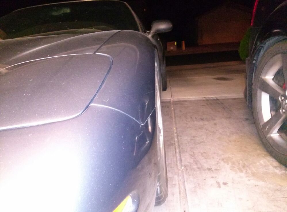

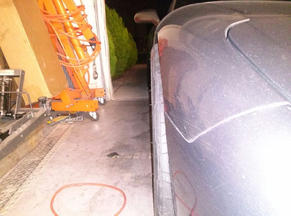

Mrr23, I think mine stick out about that far. I would like them to sit in a little further. Ill post up some pics for comparison when I get home in a bit. Thankyou.
Old Oct 14, 2015 | 01:13 AM
ascastil's Avatar
ascastil
Posts: 1,160
Likes: 171
Z06 wheel from top
Z06 wheel front

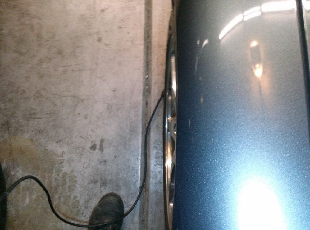

This is the stock C5 rear placed in the front to see how it fit. 18x9.5, 65mm offset.
Stock 18" wheel

According to the offset calculator, the Z06 with a 57 offset should sit about 5/16 inch out further than the stock 18. That looks to be about even with the fender.
